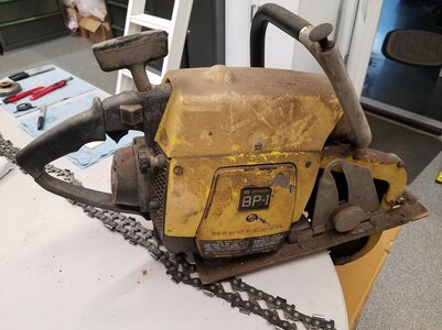

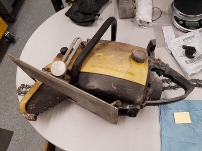

Here is something you are not likely to see anywhere else...

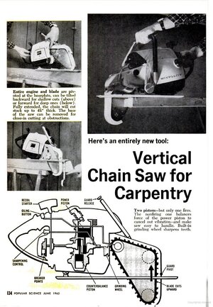

I will have to remember to find the old Popular Science magazine that had an article on the McCulloch Plywood Saw. If I remember accurately, they went on about how fast this would rip a piece of plywood compared to the other saws available at the time.

Very cool Mark - That is definitely a piece that needs displayed in the Dike, Iowa McCulloch museum.

That's awesome, it will look really neat when you get it cleaned up!! What size chain does it have? Is it scratcher chain? Looks like it has two of the same cutters and then alternates...neat!

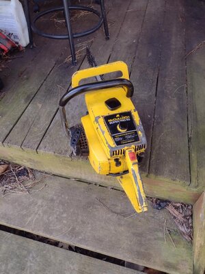

I got the SP60 yesterday & went over it quickly,then I went out for lunch.It seemed to have pretty good compression & looked to be in great shape.I came home & checked it for spark & got it to fire.The fuel filter looked new,so I didn't bother changing it.I fueled it up & in a few pulls it was running,albeit at a high idle.I turned out the idle screw about as far as possible & it seems to be about right.The manuial oiler works.I went to shut it off & it didn't.I played with the switch a bit & then it shut off.I went & got some spray lube & shot some onto the switch & it's working as it should now.I think I lucked out on this one.It also came with 3 chains that are like new (one of them is new),2 extra spark plugs,& a scrench.

Looks nice, far as the high idle may fatten the low a touch to drop the idle speed if the idle adjustment screw is all the way out.

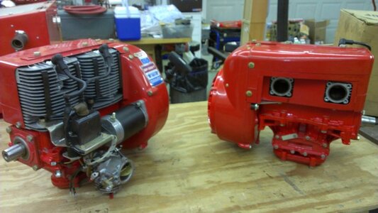

McCulloch BP-399T
They are very smooth, and very fast...
Mark
Sure wish they would have actually made a run of a decent amount so a person could actually run one and have some spare parts available. China clones maybe 😂
Actually on second thought can’t imagine a China clone of a bp 399 coming apart at speed between your legs on an old tnt or skiroule ect.
