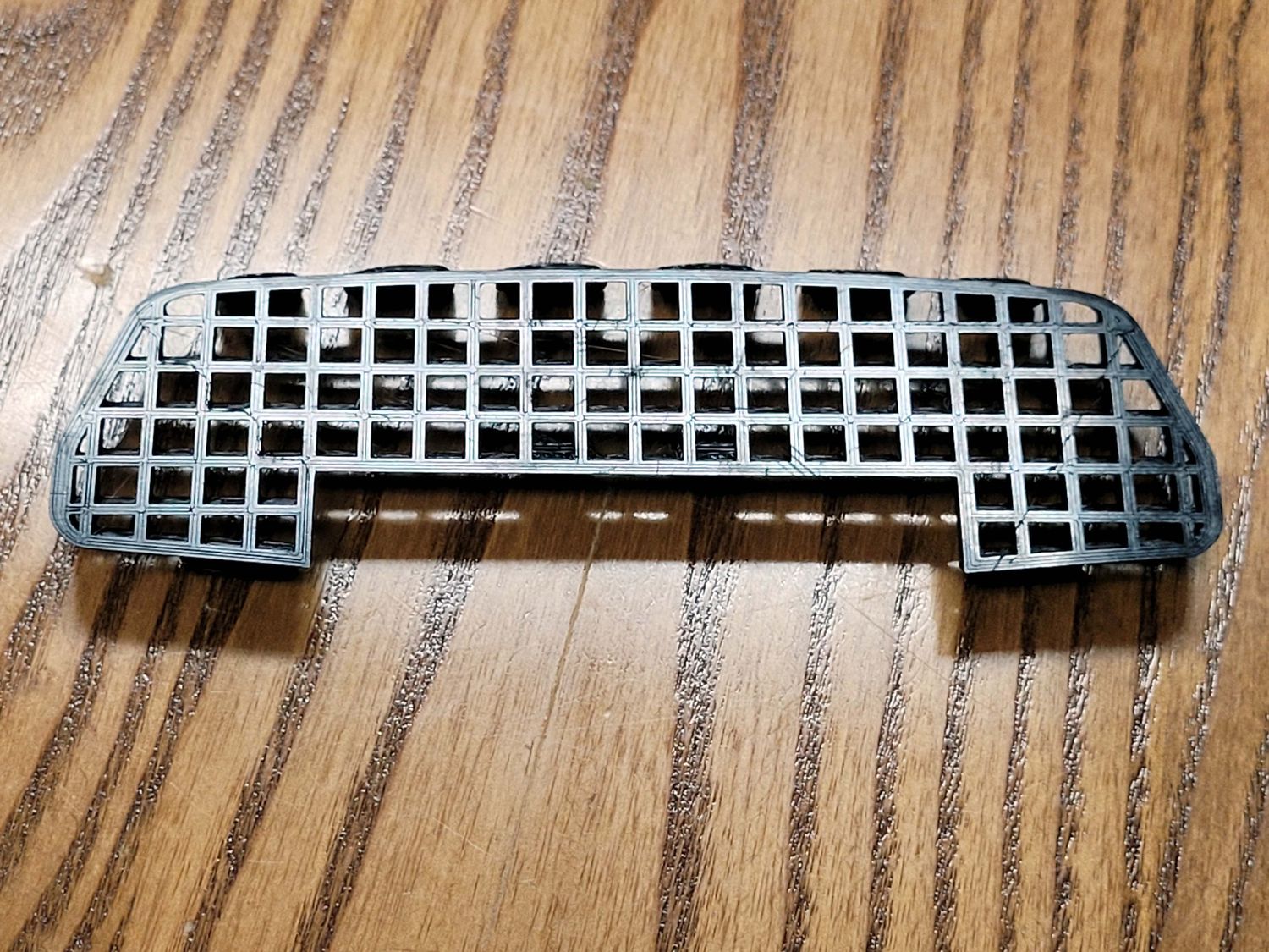

We have tested and are making a new reproduction Top Tank Air Cleaner Grill for Large frame McCulloch Saws. It's made with flexible plastic for superior durability to original parts and 3D reproduction parts. Pre-order at the following link https://www.oldsawshop.com/McCulloch-Top-Tank-Air-Cleaner-Cover-Grill-p661388112
Reproduction parts are now in stock and ready for shipment. All pre-orders have been shipped.
