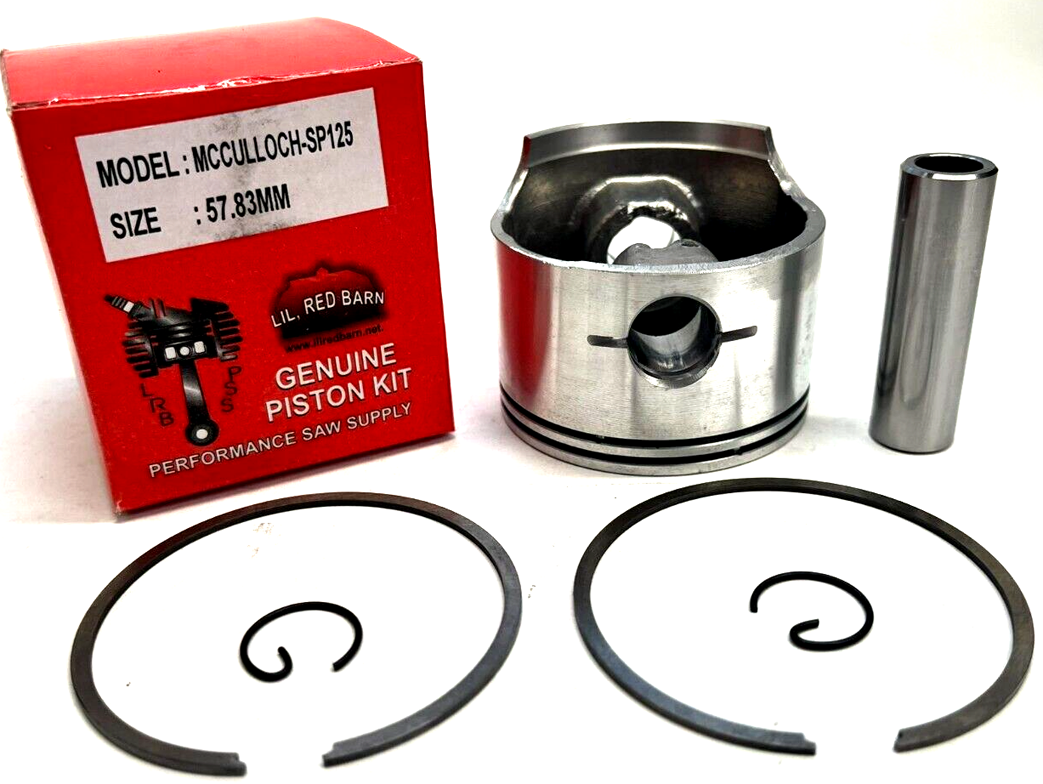

What’s ur opinion on the quality JJ ?
I know I'm no JJ but the LRB piston I got for a poulan 4200 was pretty crude as far as the casting and the machining. They are made in India. Lots of sharp edges and other little things that made me wonder. It fit well and the saw ran but I sent it down the road before it really got any time on it.
If it's the only option they will work. I'd try for something else first if at all possible.
That's my take on it too - I bought one for a Dolmar application for which there was nothing else - it was really rough and not the best fit in the bore. I had to do a lot of work to it to make a runner.
I used different rings (Caber), and a Meteor wrist pin and clips - Lots of sanding and filing on the piston.
