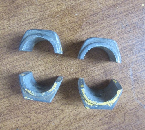

I think the world's gone mad... $61.00 for used handlebar clamps???
How about that NOS Tillitson for 125 carburetor, sold for 495.00 a couple weeks ago , that’s crazy
