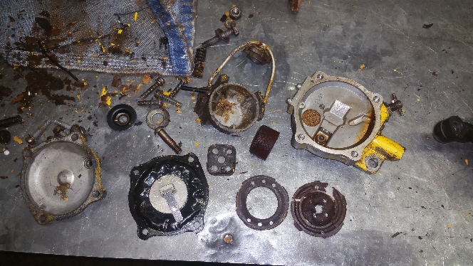

I'm getting ready to make another diaphragm for a model 73 and have a question for you folks that have made your own diaphragms. Am I better off riveting the lever plate on to the diaphragm material or is gluing it an option? If I can use a good adhesive/sealant to apply the plate to the new material I'm all for that. I'm just skeptical of any sealants/adhesives being real effective.

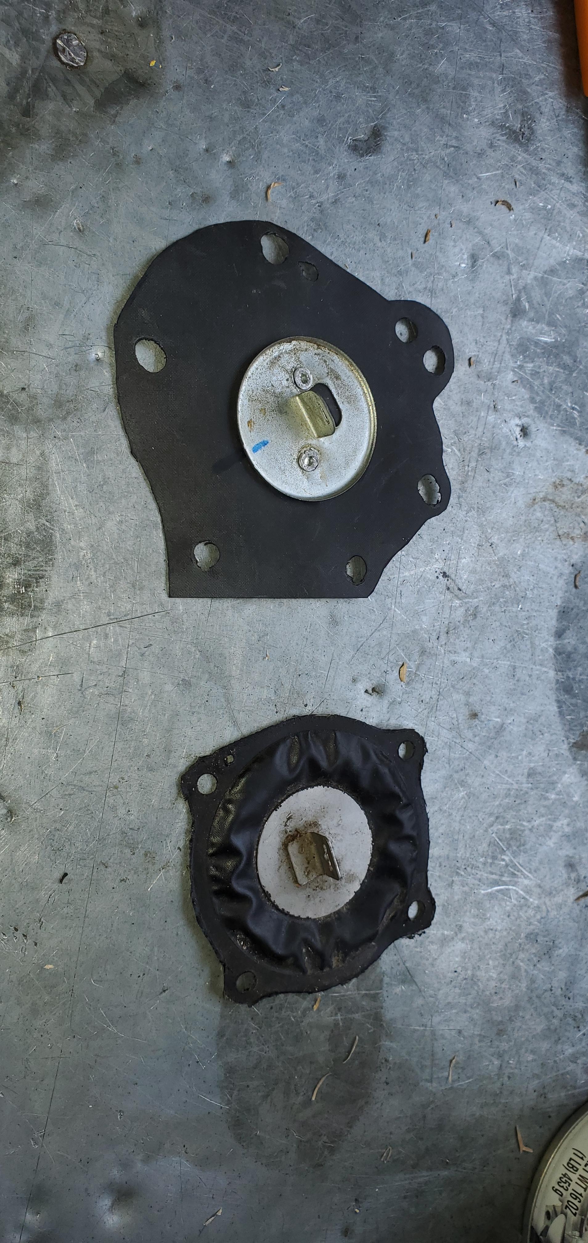

Story time with Uncle Al? I was sitting on the edge of my chair hehe(just being a smartass). On a serious note though the heavy part is an understatement, the thing is a real boat anchor. The one I have has a 32" bar with 1/2" chipper chain. With the rivets..... thats what I did with the diaphragm I made for the model 99. I have some 1/8" semi-tubular rivets that should work providing I cut out a back plate to sandwich the diaphragm material. I initially thought that would be better since after I peen the rivets in then its done with and that's that. However I'm worried about adding unnecessary weight to the diaphragm and impeding it's functionality. I know Bryan Gray did it but I don't know how it panned out for him. This is where I thought adhering the lever plate to the material like the original diaphragm would be advantageous.

Finding the right material was a pain. Actually I couldn't find anything here in the states. I had to order this stuff from the UK. I'll see if I can dig out the info from the order and the company I got it from. I've got plenty of material left. If you want to send me the old diaphragm I can make a new one for ya

American Rubber Products sells nitrile cover nylon (the stuff the diaphragms are made of) by the yard. If anyone would like to try their hand at fashioning their own diaphrams let me know and I can sell you an appropriate sized piece of the material.
I used a LocTite product to secure the plate to the diaphragm but I don't remember the numbers on the product right now, I do recall that it did contain some butyl in the mix. I also remember that the specifications say it retains 70% of its strength after 1,000 hours immersed in gasoline. I have one on my 77 and it runs just as well as it did with the OEM diaphragm.

Thanks Mark. Does Loctite 380 ring a bell? It's a black low viscosity adhesive, no butyl though. Its data sheet states it retains 70% initial strength after 1,000 hours of exposure to gas. The 401 that Al mentioned looks like it would also do the trick.
