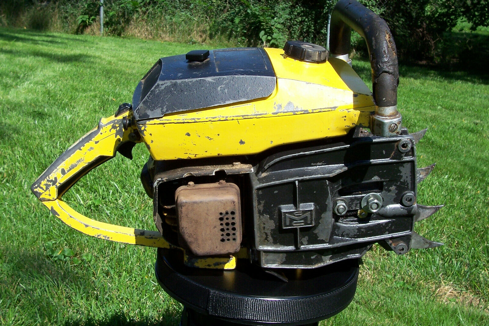

Seller is Mike Jensen, some folks may know him from Collectors Forum. If I remember I'll call him tomorrow and see if he has looked at it that closely.
Mark
fossil
11:58 PM
374
1,925
8,946
Ontario, Canada
I have a bunch of Homelites but certainly not all of them. I've never seen one with bolts down through the top like that.
Looking forward to seeing if anyone recognizes it.

There's a couple of Homelite mufflers that are pretty close to an SP muffler - One I think is the 1020XP muffler. I don't necessarily think it's a bad thing, since
the SP muffler is just an open box. I have seen some interesting home-built replacements over the years. In fact, I have a homemade muffler in my stuff somewhere.
