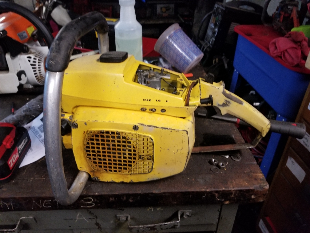

The seller wont go less than $80 plus the $28 shipping I'm not sure it's worth it. Especially for a non runner that may turn out to just be another 54cc saw.

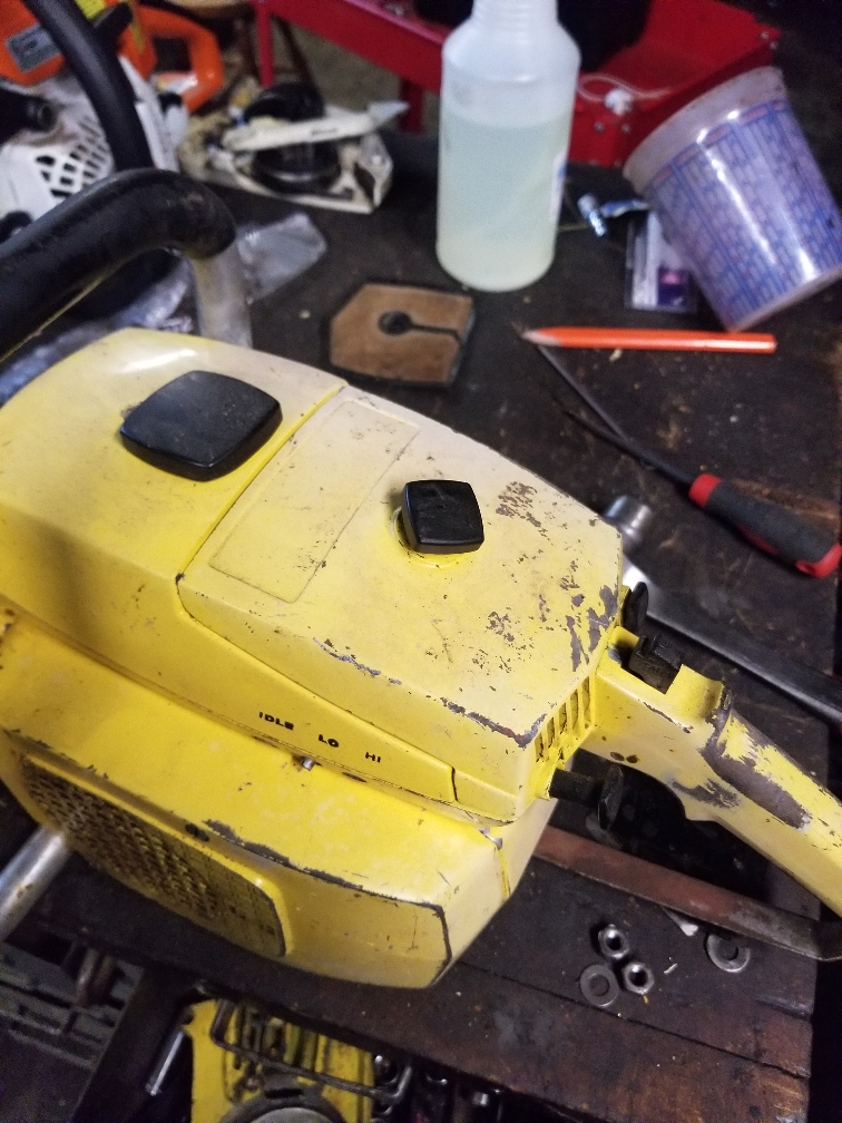

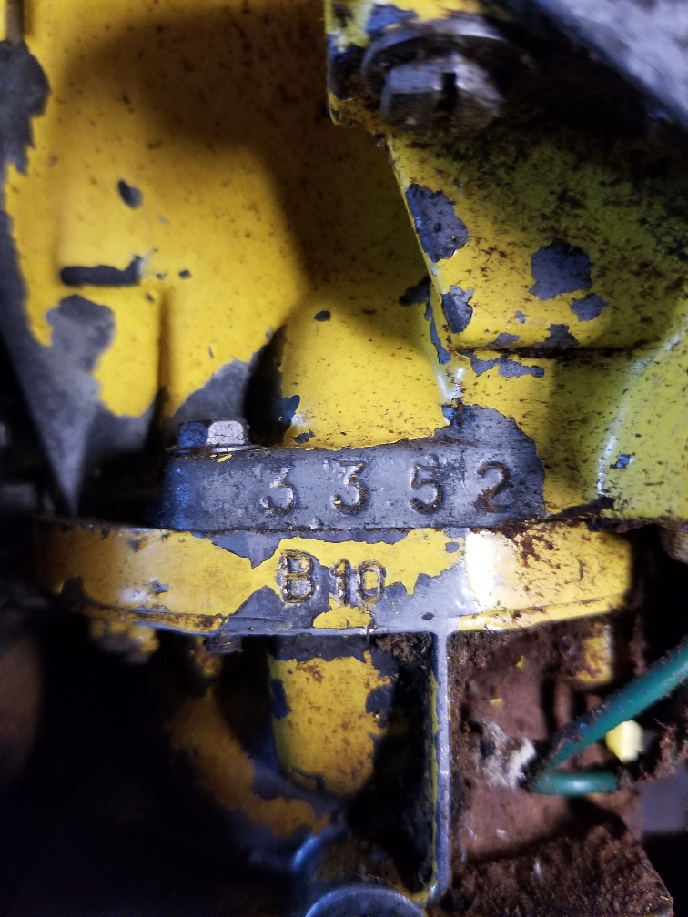

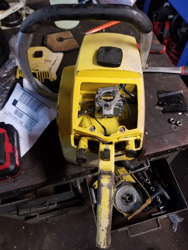

So I bought this thing..... not 100% sure what I have but I'm thinking it's a 6-10. No auto oiler, first 10 series I've seen without, SDC carb, pro mac style tank, and it is definitely 70cc, pulled the muffler to verify. Good news though, it runs!!! Will need some minor stuff.
Should be an SDC. Early ones had a McC logo on the fuel pump cover. Otherwise it would be a tillotson HS. But those did not come untill the LHS 7-10.
Sorry, my wording was poor. It is an SDC. I meant it is the the first 10 series I've seen without an auto oiler.
Most all the early yellow top 10 series where manual oil only. Easily converted by installing an auto pump.

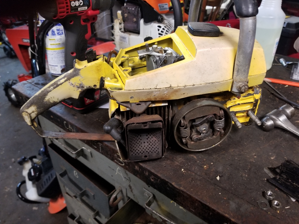

Well the fuel tank gasket swelled up sitting over night and is sealing so I grabbed a 20 inch bar off the wall and spun a loop of chain for it and took it out and sunk it in 24" oak log. A couple twists of the screws and it singing like a Mac should. I think I did ok for $100.
I would like to swap in an automatic oil pump especially if I plan to use it regular. I'm assuming I need a 3 bolt aluminum body pump?

Cool beans.
Certainly preferable if the tank is threaded for it. I was surprised your 7-10 was. My SP81 isn't and has the spring clip instead.
I drilled the 7-10 for the other two screws. So far, all of the RH start saws I've had here where 3 bolt.
You can use the plastic body pumps as they are also threaded for 3 bolt install. You just cant crank down the screws like a gorilla!:D
The pm700 @Gizzard has uses a plastic pump i drilled for 3 bolt install.

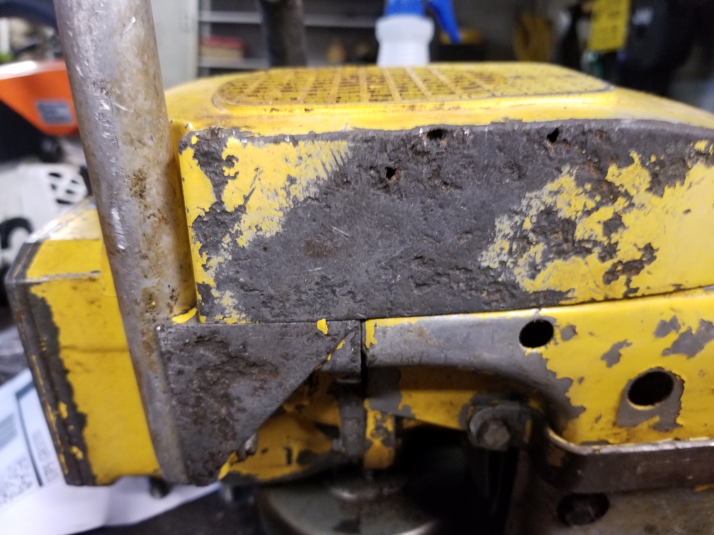

Maybe I’m just not used to how old saws look worn out. I’m used to clean, shiny modern saws lol.
All seriousness though, modern saws use a lot of died plastics that hold there color through use and abuse. These old saws where all painted metal and the paint was just industrial enamel and not known for its durability. Make no mistake about it, I have some seriously ugly Macs that will run right alongside any modern saw.
This particular saw appears to have sat in a windowsill for an extended period of time hence the fading on the recoil and bar side of the fuel tank.

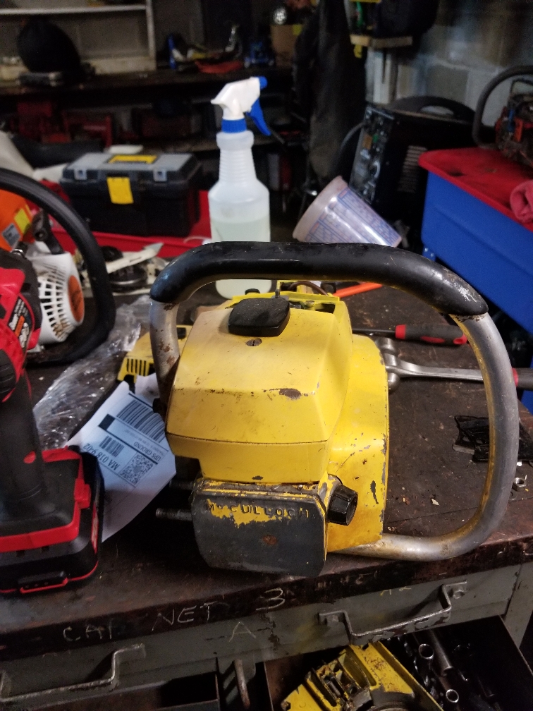

Just a quick note to let you guys know it's still me, Kevin. I realized I spelled my own name wrong in my user ID so I created a new account. Looks better now lol.
I'm pretty pleased with that 6-10. Went out tonight to try a cold start. Fired in one pull on choke, pushed in the choke and running on the second pull.
