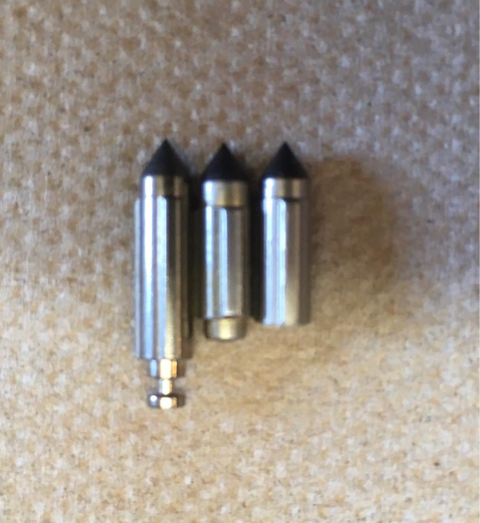

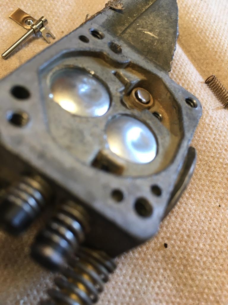

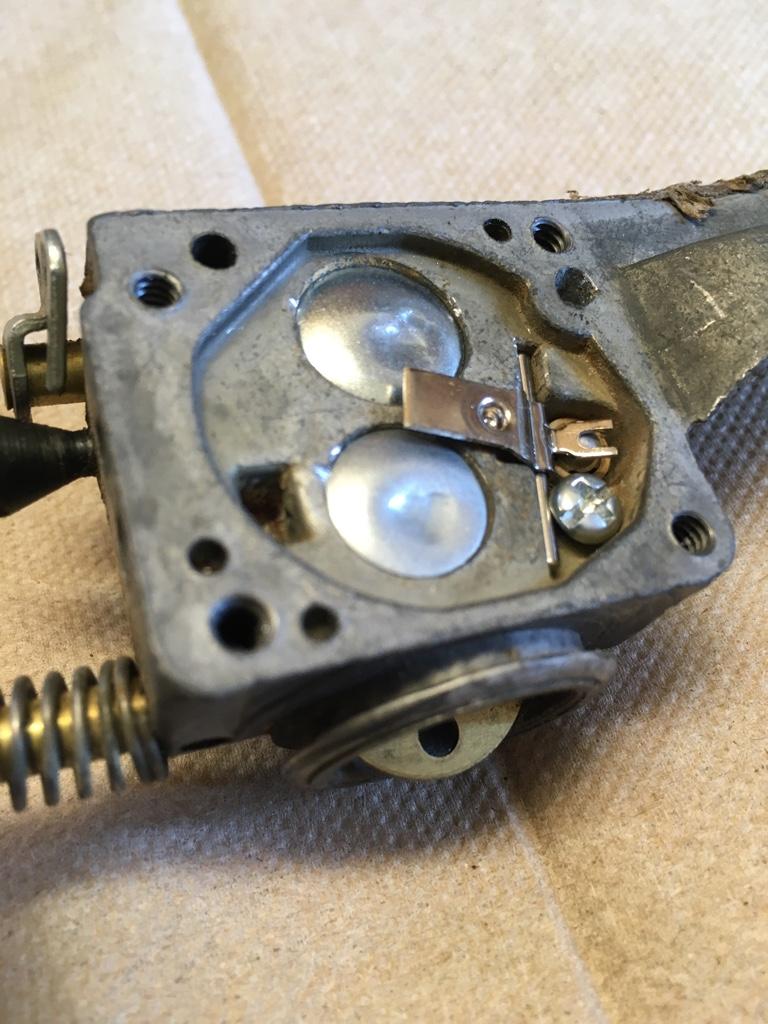

Snatched a metering lever out of another MDC kit.
It moves freely but the lineup/angles suck.
It’s worse with the ‘door knob’ needle supplied in the kit.
Shorten the needle with a cut off disc in my Dremel, I will. [emoji848]

Will putting the fork of the lever through the notch in the needle help? Seems like that lever geometry was made for that setup.

You have to fork the "door knob " with that type lever . You might have to bend it to get the proper alignment with the diaphragm .Walbro as well as most if not all carb makers have web sites showing set up adjustments ,trouble shooting etc . With few exceptions most diaphragm carbs all work about the same .

Made my own slightly shorter needle (right side).
Used a razor saw on a leftover (left side).
What I found in the carb is center.
The short one sticks up above the brass just a touch so the lever won’t bottom on it (brass tube).
Geometry is much better.
For lack of anything to go by we set it level with the housing rim.

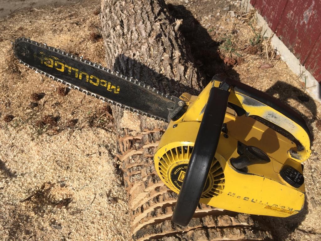

Runs and cuts. [emoji57]
But it became obvious the crank seals are sucking air. Makes it tricky to get the mixture right. [emoji90]
And, the auto oiler isn’t oiling. [emoji2959]

Saw looks to be in decent shape. At least its running. Now to the rest of the list of problems.
