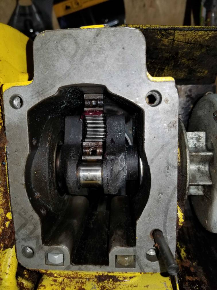

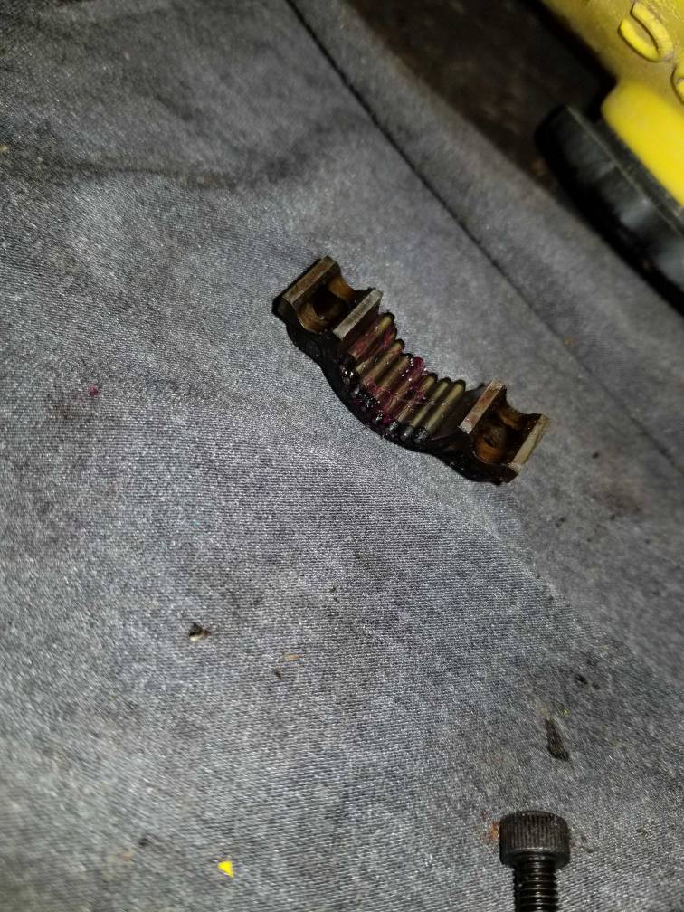

Ok i need some help. Putting piston and rod back in my d44. My son bumped the needle bearing tje other day. I got 17. Anyone know how many ther should be?

24 on the needle bearings. The Kart guys used to leave one or two out to free it up a bit, just make sure you don't leave any loose running around it the crankcase.

Although I could not find the IPL on the D-44 in looking at other IPLs it shows 24 needles on every other reed valve engines .On some of the kart forums they mentioned Terry Ives has them .
I found the rest of them. They were stuck to the magnet on the parts tray got them back in today. Just trying to figure out the trigger assembly. Think i got it figured out. If anyone has a teardown of it they could share i would appreciate it. Thanks again.

I found the rest of them. They were stuck to the magnet on the parts tray got them back in today. Thanks again.
That was good with the parts tray. I need to do that when working on them rollers as have lost a few myself in past.

Be careful using magnets on the rollers Kevin. They can pick up some magnetism and hold metal filings. I dont know where the metal comes from but it seems a magnet always finds filings.

Good point @Steve. I had not used a magnetic tray before. It just got me to thinking (I guess a bad thing :))...I've lost a few rollers before...maybe a few brains over the years too.

The roller should be hard enough that they are not easily magnetized. If you only have them exposed for a short time it should not be an issue. Even if they do pick up a bit, the shock they receive when the engine is running should knock it out in short order anyway.
