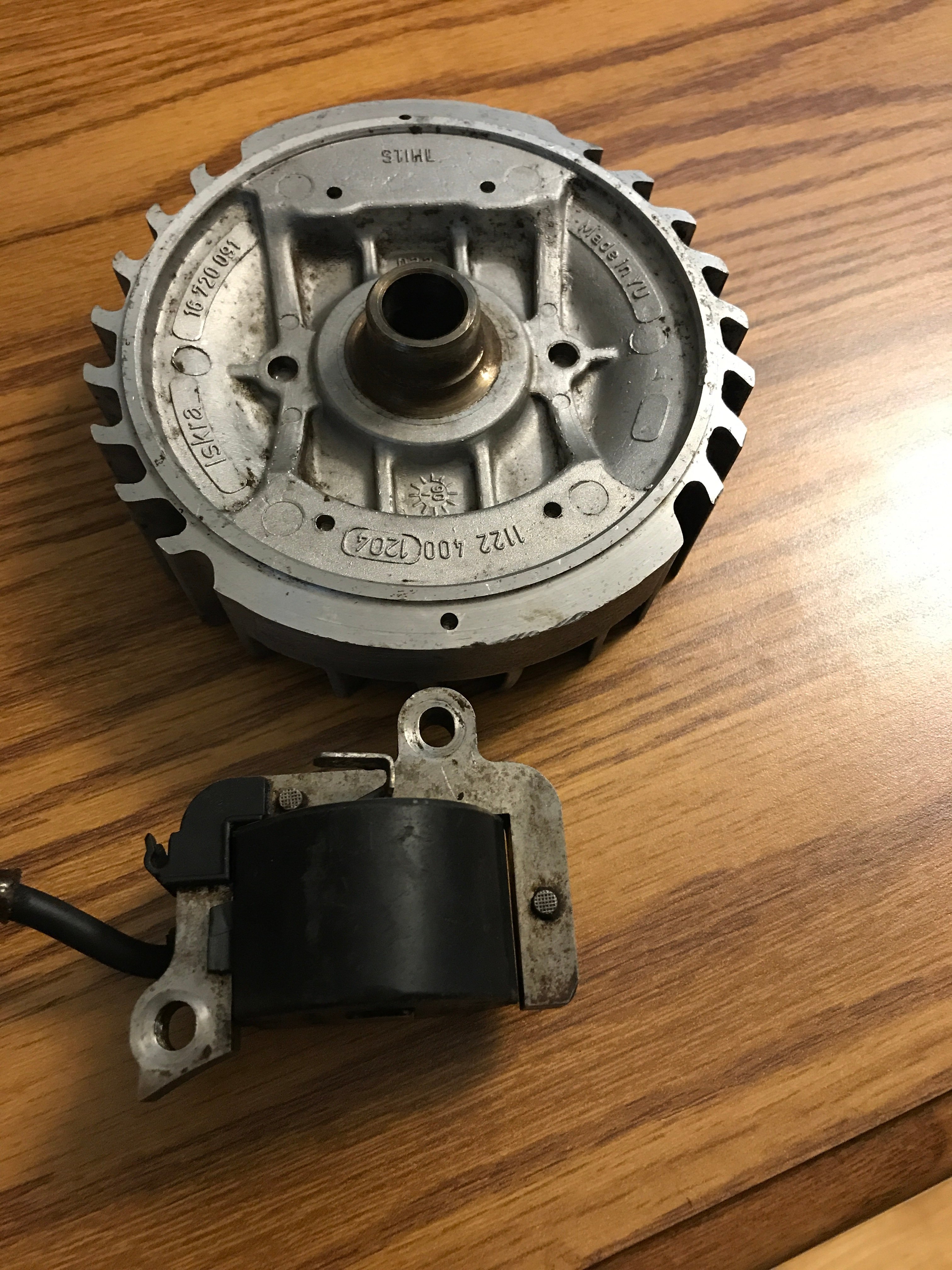

Got a coil/ flywheel question... first , there seems to be no spark, so I’m wondering if these parts even go together

If its a single keyway, wrong coil, for use with limited coils. But you still should get spark I think, it will just make it a *b-word to start, probably pull a few joints. If its dual keyway it will work, but you've got to put it in x or b slot. That looks like a dogleg coil, unlimited coil.

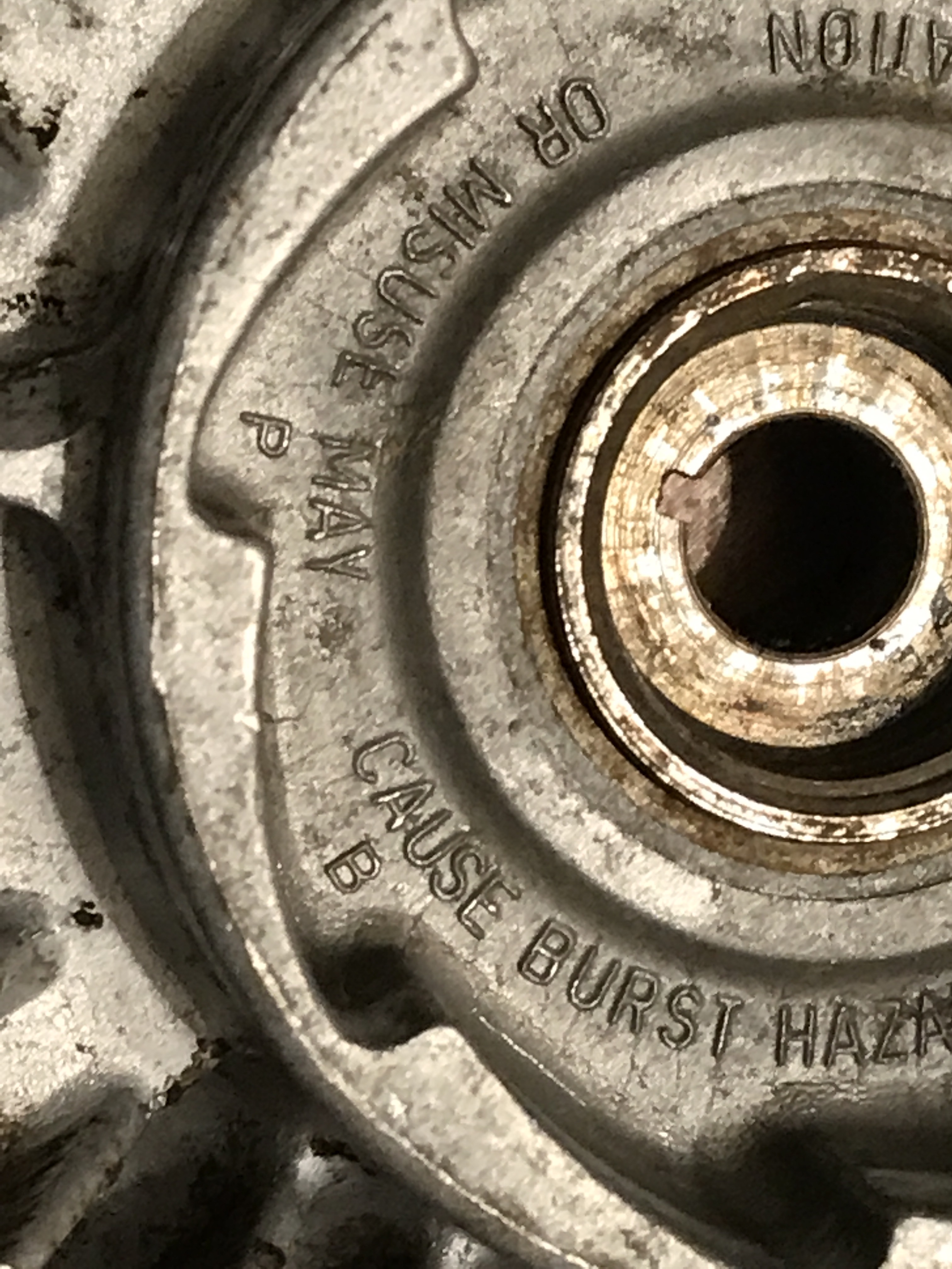

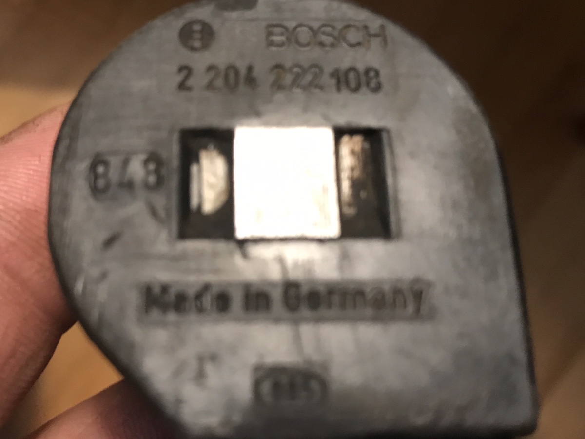

definitely single key, does the “P” & “B” look like a clue? B for Bosch maybe?

B is where the unlimited slot would be if it was dual keyed. Seen that alot, limited flywheels and unlimited coils. It probably was because the CDIC coils were prone to failure and they just slapped on a unlimited coil because they didnt know better.

If your coil and fly wheel are good you should still have spark even if is not timed right.
Saw won't run but spark will be proven.
You can put any coil against any fly wheel (064/066/660)to test if a coil is good.
Yep slapped an 026 coil in there yesterday and had spark. Old coil is toast.

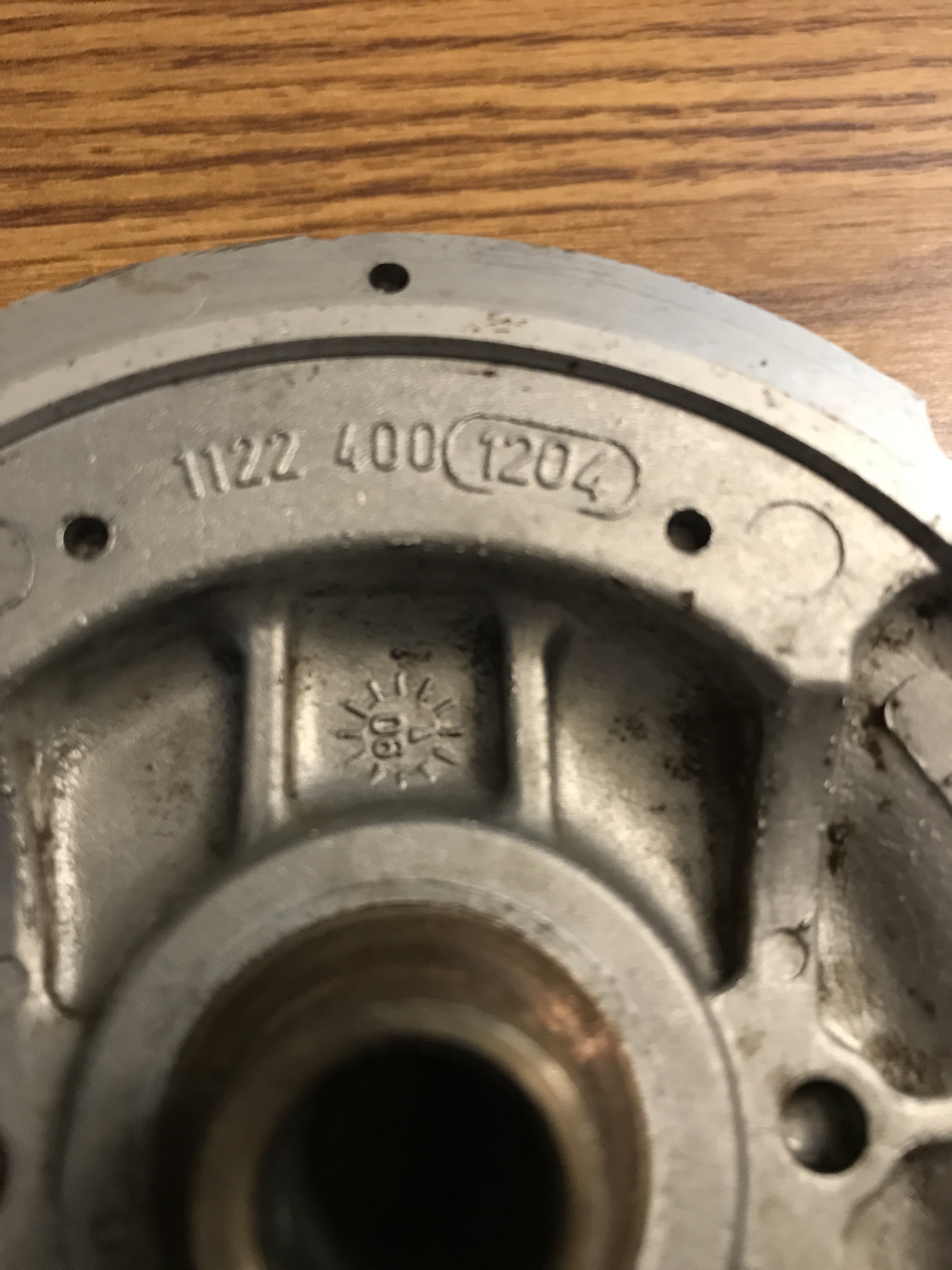

Flywheel question. I am building an 066, it is a total restoration (powdered the case, new tank etc.). It is a short case but is has a big end crank bearing. I was looking on the 064/066 thread that @Definitive Dave made about coils, flywheels and such.
It had listed that the 1122 400 1214 was for a big end bearing. I bought a 1122 400 1209/1214 and it's too small. Is there a flywheel that has only one set of numbers on it, (1122 400 1214)?

Stihl revised the metal flywheel 066 crank so that it went from 12 needle rollers in the big end rod bearing to 13, so I think that's what Dave's information refers to.
If you have the crank with the larger stub shaft on the flywheel side then you need the poly flywheel.
