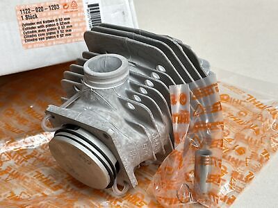

Hi all, I have had a look at the cylinder and have tried the method suggested. It works really well! Unfortunately there seems to be a fairly large gouge in the cylinder from the exhaust port all the way up to the top. I will get some pictures this evening. Unfortunately I think this means I'm going to need a new cylinder. In this case what is the collective opinion? I can get an OEM 066 cylinder and piston, or Meteor. Or I can get a Meteor 064 cylinder and piston. I have not yet found out if I can get an OEM 064 cylinder and piston, but the closeness in price is leading me to lean towards the 066 top end route either meteor or oem.
If the cylinder isn't salvageable, this is what I would be getting:
Maybe I'm the only one who has been burned by Hyway and Meteor cylinders with plating failures, but I can't recommend them. As for going 066 or 064, the 066 isn't a bolt-on. It requires the same type of modification as doing an 044/046 hybrid.

Unfortunately got side tracked away from this, but had some time to look at it again. Today I replaced all the fuel lines, and the fuel filter. I washed the tank out as well. There was definitely some water in the half tank of fuel the saw came with which wouldn't have been helping. I replaced the plastic surrounding the clutch drum as it was only a couple of pounds and the burn mark offends me when everything else is okay. As the plastic had melted I guess the clutch has got fairly hot so I replaced the clutch springs and drum bearing. I have also cleaned out the carb, and rebuilt it with new gaskets and diaphragms so hopefully that is ready to go. I have also just checked the squish which is coming in at 23 thou. Hopefully can get it back together tomorrow and see if it will make some noise!

I have never has any luck replacing just the rings only whenever the piston is worn as badly as yours is. Get a complete kit and replace both the P and C. You will be glad that you did.

I thought I had updated this thread, but obviously not! I decided to bite the bullet and buy a genuine brand new 066 piston and cylinder for it. I also bought the heavy duty filter kit, dual port exhaust cover and the west coast style clutch cover. I put it together, and as expected there was a bit of work getting the cylinder to fit. The 064 uses m5 bolts and the 066 uses m6 as well as the spacing being slightly different. The 066 cylinder will just about bolt on using the m5 bolts as the clearance in the bolt holes is just enough with m5 bolts. I was a bit afraid of the threads stripping so I rethreaded the crankcase to m6, and then filed the cylinder to fit. I also sanded the base down to achieve a tighter squish of around 23thou. The saw starts easily (no decomp so you have to be firm with it) and runs well. There is an oil film around the piston with this compression check but it is at about 165psi. It is an absolute ripper and is still running in. Very happy with how this turned out.
