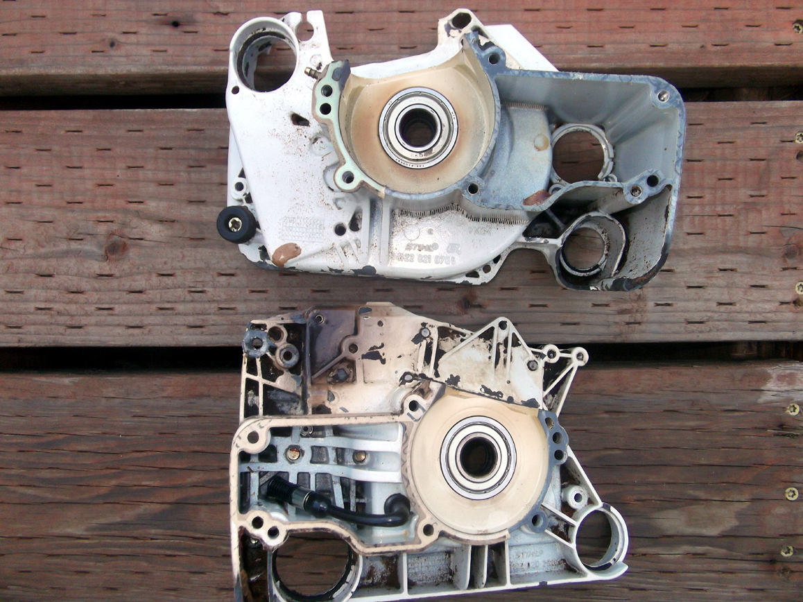

I thought I'd show you guys this - I bought this parts saw from a member here, it's an original 066. It's vintage circa late '93/early '94. The case has never been cracked open.
Over the years I've mentioned that Stihl used sealed bearings from the factory for a short time - here's the pudding:
That’s cool! Thanks for sharing

In a chainsaw, it seems like you’d want the crankcase side of the bearings to be exposed to fuel/oil mix to get lubrication under hard loads running hot. Seems like they would be getting less with that side closed off?
I think the idea was to keep debris out of the bearings. Even though they're shielded bearings, some lubrication from the fuel mix would "burp through."
Actually the opposite happened though in terms of debris - fine sawdust would make its' way in there and the bearings would get packed tight with it and fail.
There were a lot of debris-related bottom end failures early on and Stihl's engineers finally figured out that it was an air filtration issue.

Thanks JJ, makes sense to me. Very interesting info!

My early 066 has shielded bearings in it, they are not sealed as such and the mix is thin enough to get past the shield. Like JJ says the air filters need to be maintained meticulously to prevent debris from getting past the filter especially around the sealing edges, some saws airfilter covers just did not apply enough pressure to seal the best, shimming and hard grease helped a lot.

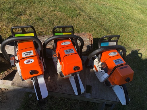

3. 064 all ported 2 by a monkey and 1 rattler did

The bearings are the same size and configuration throughout the series (064, 066, MS-650, MS-660). The part number for the PTO side bearing has changed because
they changed the design of the cage a couple times. Somehow, word got out on AS that the poly flywheel saws use larger bearings and that's not the case. It's the flywheel
side oil seal that's larger.
This was a result of jms and other *pretty boy “builders” saying the bearings were different.
No one with extensive 1122 builds would claim it... and I know you and I have corrected a few along the way.
