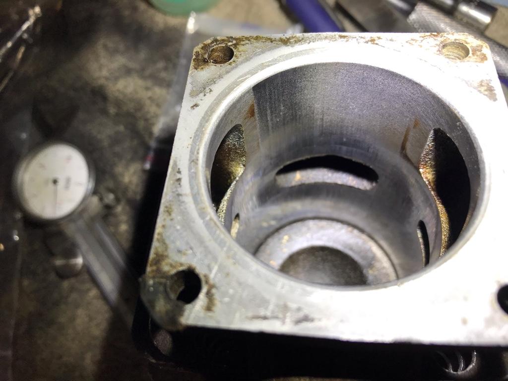

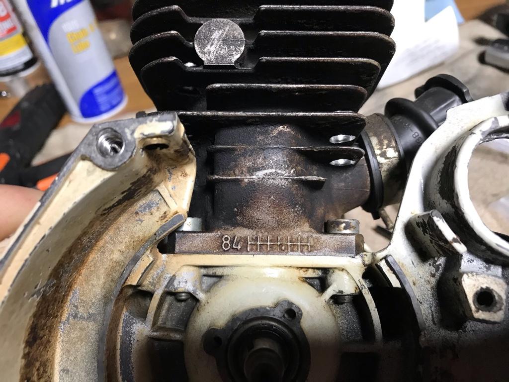

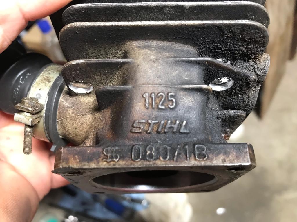

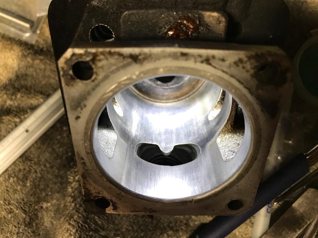

Could we get a couple of cylinder pics on that saw. Inner and outer pics please apply. Thanks, Tim
Here’s the cylinder pics. Love to hear what you all have to say about this one. No scratches whatsoever. I want you reuse it. The pop up piston did not equate to hi compression unfortunately. Whoever thought of it had the right idea though

Just like Doc said. KS plating//cylinder is lighter,brighter in color. I am curious if it is a 46 or 48mm bore. I think the exhaust port edges//plating need a little debur and something has made an impression on the floor of the exhaust port. It looks great to me a very useable. I'm no expert by any means. I do have an 028.Super, and a KS 034 46mm p&c. Now you have my interest on doing some checking on a 46mm assembly with pop up. Looks as if the combustion chamber can handle it. I don't know why your compression wouldn't of increased unless the squish was too great or piston timing actually lowered it. Again, Not sure if the 034 Super had a pop up from factory like the 028's. Someone will be along to advise. Thanks for taking the time my man. I'll leave it at interesting!! And knowing your bore size will help with information. Thx. Tim

It’s a 46mm bore. That’s why an 028 piston fits. It is not a super. The squish is way to big though. It didn’t even dent the solder. Compression was around 120.
