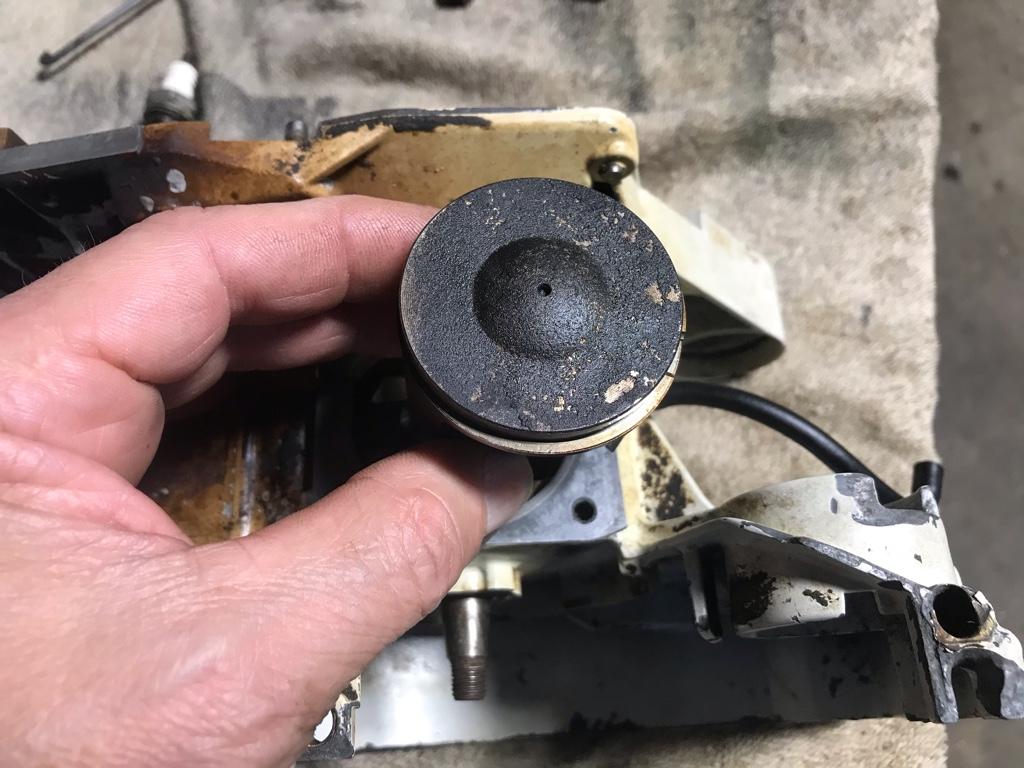

Hey guys, I’m doing an 034 as we speak. Found this piston in it. Looks like an 028 in there. Shopping for parts now. Just want to make a fun saw. Recommendations?

Interesting. Must be an early one.
Could we get a couple of cylinder pics on that saw. Inner and outer pics please apply. Thanks, Tim

I'm wondering if that is a 028 Super piston 46mm in a standard 034 cylinder? Would any of you more experienced guys know wrist pin info, and piston heights or skirt info? That could be a low budget hot rod build.
