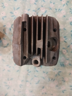

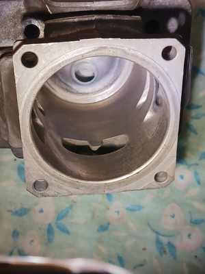

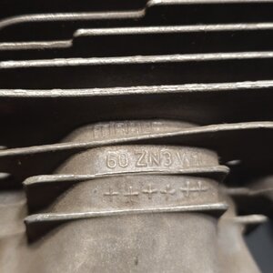

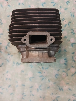

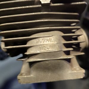

So I found this on eBay. It was listed as an 066. I hit the buy it now button before I dug into it because of the price lol. After I bought it, I realized it said 1124. I think this is an 084 top end. looks new. Am I correct? Any idea what they are worth? Thanks

I believe the 60 part on the 60ZN3W means 60mm bore, if you found a 60mm 066 top end I'd love to see how that sucker runs! 084 it is, as for value I have no clue.

Decomp on top and not a 10 mm fine thread ?
Could be a 880 cylinder if it has a 10 mm threaded de comp
Clamp on muffler 088
