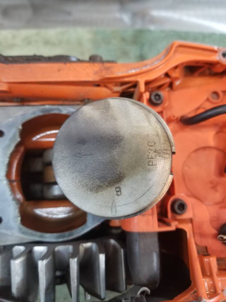

Do these numbers seem remotely accurate?
Mkinslow
6:33 AM
2897
Mar 26, 2017
2,672
11,736
Tennessee
This is my 365 with right at a years run time. Keep in mind I dont cut a terrible amount. Mostly fire wood for the shop and cutting for others that need it. So around 20-30 tanks on this saw.
Mkinslow
6:33 AM
2897
Mar 26, 2017
2,672
11,736
Tennessee
But at 73* I get 214 duration. Is that right. From what I've been reading you take the timing number and times by 2 then subtract that number from 360 and that's the duration number. Maybe I missed something.
