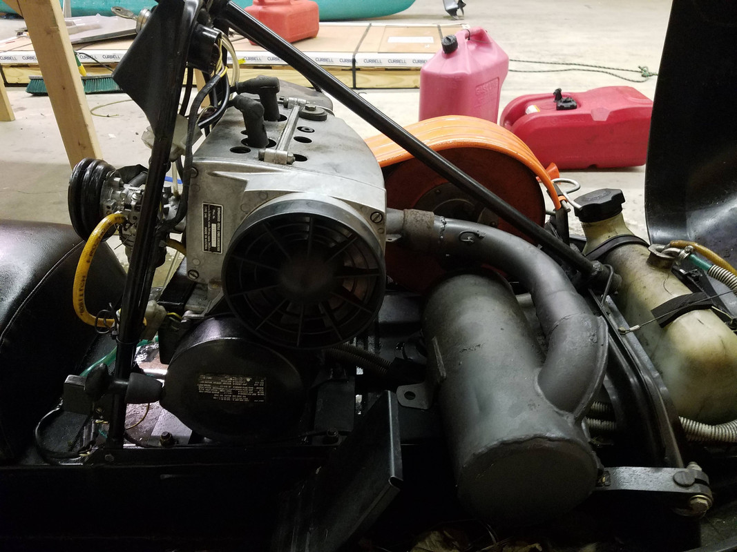

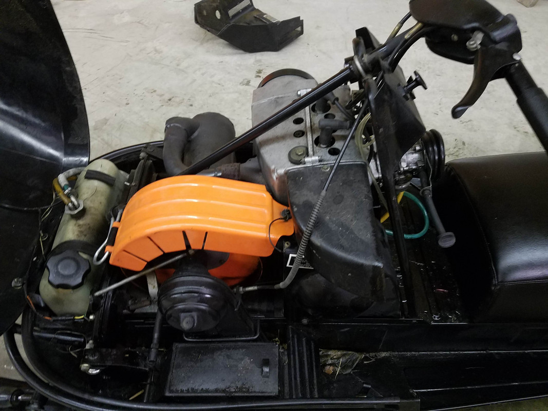

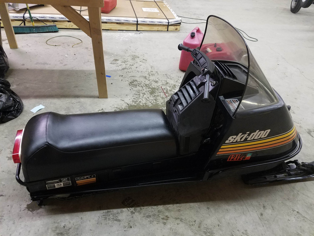

Tune alot different two strokes up here in Alaska.
Rebuild vintage 2 stroke snowmobiles, and boat motors as well. Probably go through about 200 gallons of 2-stroke mix a year. Have rebuilt tillotson, tekei, mikuni, rochester and walbro carbs.
All my 2-stroke stuff is tuned where it should be, including this 881.
Weirdest carb i ever rebuilt was a stacked tillotson on an austrian 250 twin, in a 1970's elan restoration. It had identical bore/stroke numbers, a square bore. Thing revved like a fkn moto-cross bike. The fuel pump, fuel filter and carb, were all stacked vertically together. Ran better than a mikuni roundslide.
