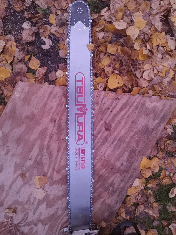

Finally replaced that defective/cracked stihl-born bar.

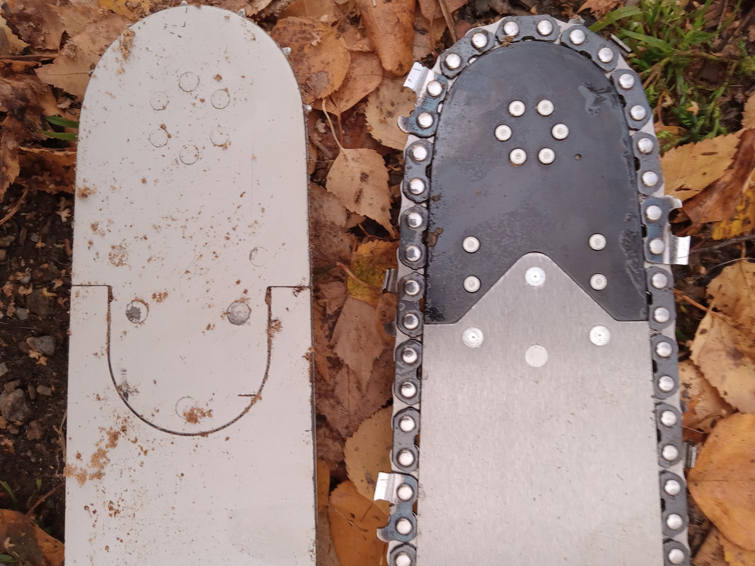

Definitely different steel on the Tsumura 218PV5. It's a stiffer bar. The oiler hole seems to flow better. More rivets on the nose sprocket. Shorter nose sprocket as well, so you can clamp the Alaskan mill closer to tip.
The tsumura is a 107 drive link, the stihl-born bar is 108 drive link. Even in spite of this, I still had to back the chain tensioner way back to mount the bar. Might be a taller bar. A very good $118 on Amazon.

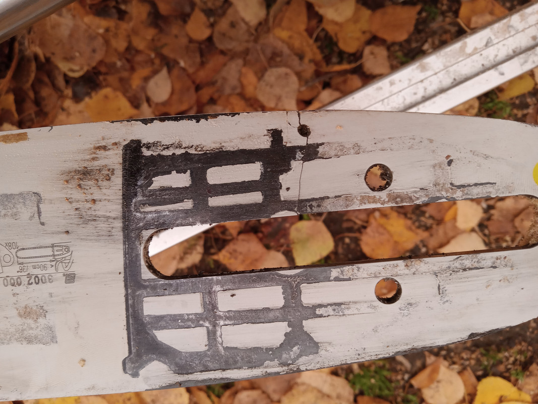

I'm still cringing over that crack. I was on a time critical/paid job, and continued milling for 10 hours on that cracked bar. Didn't have a back-up. Never thought I'd need a back-up on a fkn six month old .404 bar?
I'm so lucky that thing didn't come undone. If it did, the chances of severe injury would have been a strong possibility.

Chief, I couldn't in good faith, sell something damaged/defective. I will keep it around, as a good conversational piece, like oem stihl, made in turkey, plastic caged crank bearings.
Crack goes through the oiler hole.

Looks to me like the bar was only clamped tight on front. For what ever reason, back of bar was able to flex and crack.
