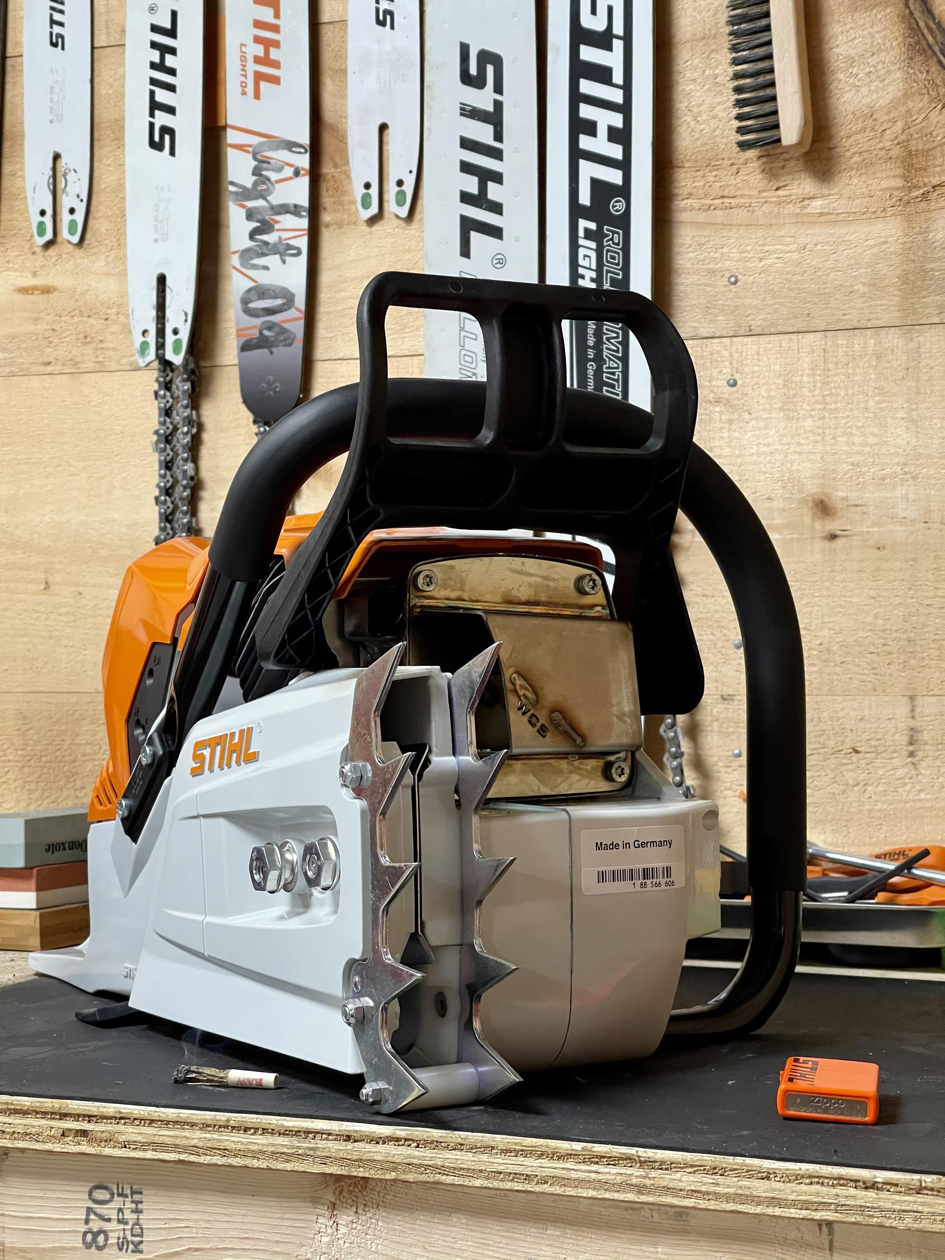

You should consider a new 880. Ported, of course
36”
404 RM
9 tooth
Hardened hickory
Brand new 880

Very nice. OEM carb? Or any carb modifications? I thought I read somewhere an 880 needed a different carb to be made right.
Carb/boot out of an 088 and whatever coil they use. That's with no porting and just done to get a new ms880 back up to 088 stock power.
The stock ms880 with smaller inside diameter boot and carb probly flows higher velocity after porting? IDK enough on the porting side of things moparmyway's ms880 runs strong without the carb boot mod as we can see.

Maybe that bark box would be better if it exhausted out the other side?

Most all of my mufflers are modded out the other side. No real problems at all.

Yeah but I’m guessing you made them go out front and to the side at an angle. This runs straight out the side and looks like a big exit so I would imagine it would cook your hand going the other way

Yes sir. Good points. Lol
