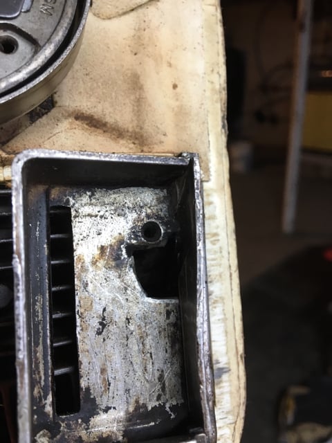

I didn't check compression. I like to get at least a little run time first. I'll check it tomorrow.
I cut open the port where the screen goes maybe 3/8". It could probably be bigger yet. I'll get a pic tomorrow too. And maybe a video...

Just checked compression. It's sitting right at 145. This is with new rings and 2 min run time last night.
Here is the exhaust mod.
I'm not sure how much they like to be opened up? Didn't want to make it to loud.
Trimmed the limiter and realized the high screw was bent pretty bad. Fortunately I saved a junk carb from a 192t and the high screw was the same. All set now.

Why is it at 145 was this a refurbished cyl ? Did you use an old piston? Did you pull the saw 12 times or till it stopped rising?

To be honest I forgot that my gauge is suddenly reading very low. The 346 I did I couldn't get above 135 and it was tough to pull over. So it's probably much higher than that... I need to get some new shrader valves...
New oem piston and rings. I'm sure it will get better as it breaks in too.
