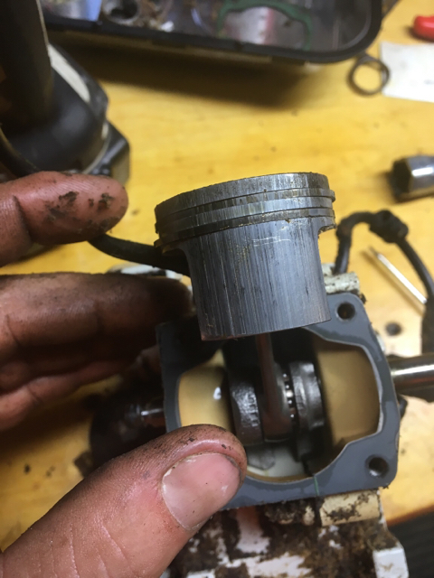

Doing a couple saws for a tree service guy. Got the 201t running good. Time to move on this 200t.
Tore it down. It's pretty dirty like the other one. I'm going to have to give him s lesson in maintenance...
Any way the piston is toast

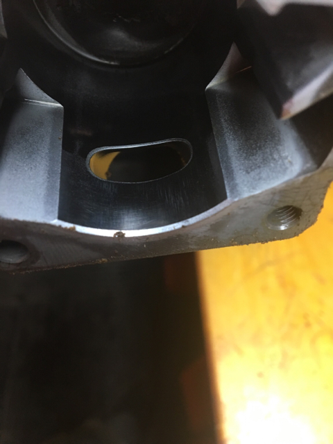

Looks like the cylinder will clean up nicely though
This saw passed the leak down test. Fuel in it at the moment is mix gas.

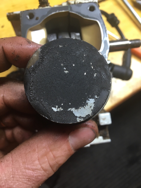

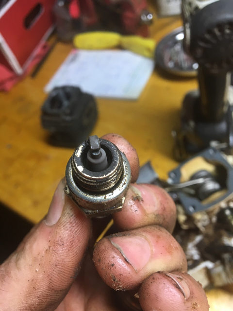

Any ideas what may have caused this. By the looks of the piston top above and the plug
It wasn't running lean.

I see alot of carbon. Looks like carbon scoring to me. Running to rich or to high a mix ratio maybe.

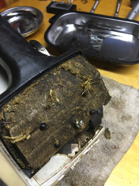

Hmm. I hadn't thought of that. It's possible. Take a look at the air filter I pulled off his 201t.
This saw had a brand new one. Maybe he thought that would fix it???
I'm waiting for a response on the story behind it if there is one...

That sure doesn't help the situation either. That would cause the saw to starve for air and fun hotter than normal. I'm surprised it ran! lol

That is a pre filter

I'd say that's old stihl oil and too rich with fuel. I have ram a few saws at 32.1 all day long and haven't had that much carbon. I bet is was dumping fuel into it to cause most of that carbon and plugged exhaust. Air filter looked good like it was doing its job

That carbon is from unburned fuel not nessesarily from oil .If it were not for the "intellicarb device it probably wouldn't have ran it all .By the looks of that plugged air filter it was about like running with the choke on .
For those who don't know the intellicarb thing works to allow the saw to run at a reduced performance more or less alerting the operator to clean the air filter .If not the damned saw could choke out while the trimmer is in the top of a tree right in the middle of a cut .That would suck with a half life .

Looks like heat, I bet the chain is dull and the fools were leaning real hard on the saw through bigger wood. Maybe cheap fuel added to the heat, does he run fresh Super or old reg crap?
