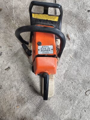

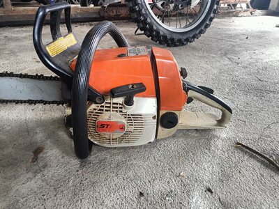

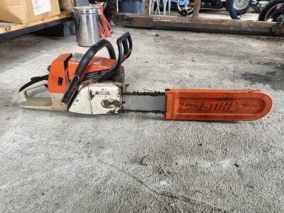

I just scored this today, haven't got the saw yet but I'd thought I'd post it here so I can find the thread again. Cylinder pics to come...
