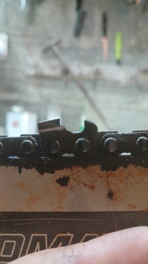

Im slowly making progress with this square filing
This is stihl rs round ground chain converted with a vallorbe double bevel file.
Ive been trying to shape the cutters to have a 30° top plate and a very slight top beak.
I tested it out this evening and im very impressed.

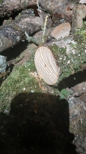

This is 4 inch diameter ash. These curved cut marks show the chain cuts very fast.
Ill try and get it into some bar length timber tomorrow.
