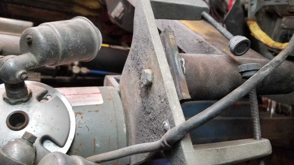

My 450 is made different sorry. For some reason I though it was made the same. FWIW this it 1 3/8" Id 1 5/8" od pipe I used on that mount. It's what I had laying around.
That’s the Silvey style mount.

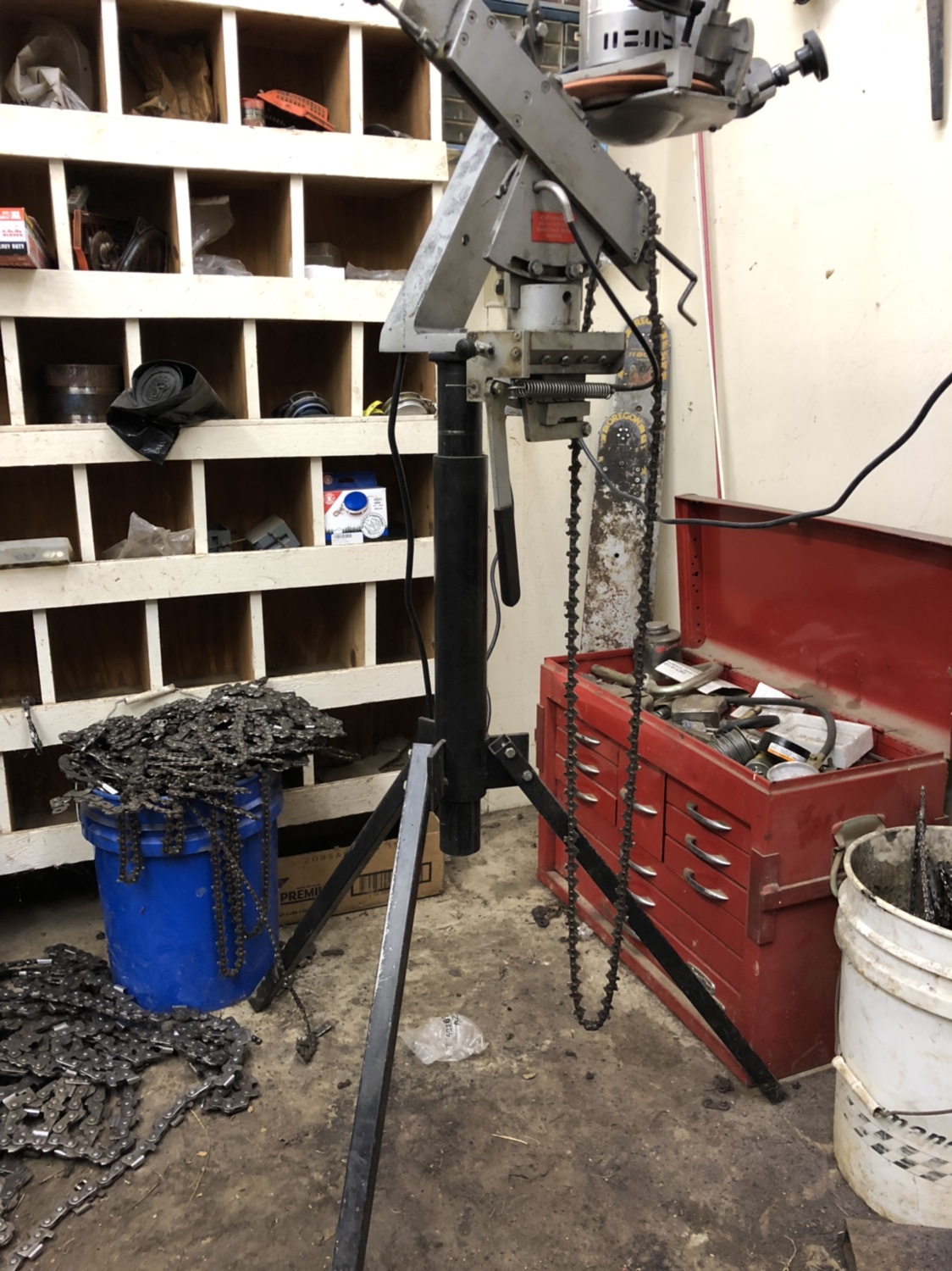

Want to make on that the top telescopes down into the bottom section and legs fold up so it comes down to about 2’-2.5’ total when folded and collapsed
When I get home I’ll run down and get you a picture of my pro sharp stand.
I'd love to try a prosharp someday! The silvey stuff is just soo hard to find.

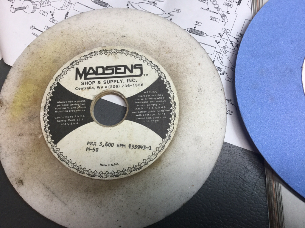

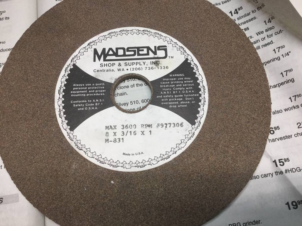

Think this is still good?
This is an extra dresser that came with the grinder
This is the multi point one right?
This is listed as a madsen’s 831 Wheel.
Seems pretty aggressive and I’m using it for converting and big changes to a tooth.
I’m really new at this but it seems really nice thus far.

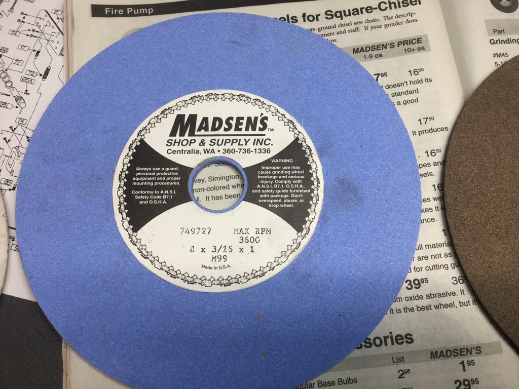

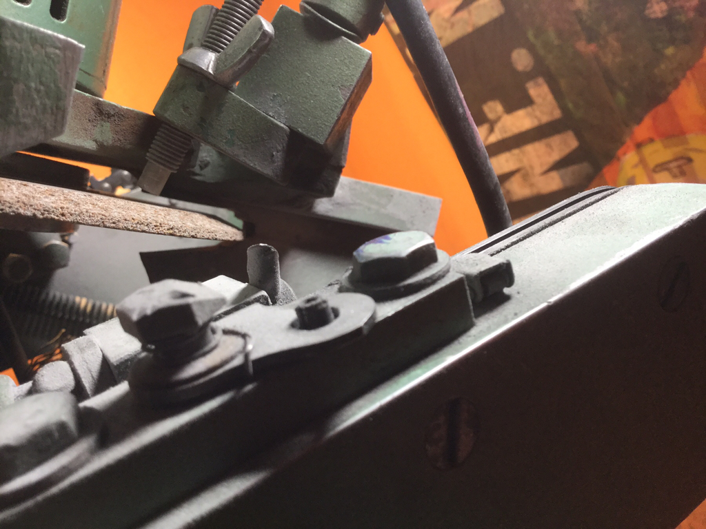

The wheels that came with,
Seriously, has anyone ever seen one of these?
Can’t find any info
This was untouched till I got it.
I’m gonna dress this ugly bugger down till I can grind Lo pro.
Other than that, the whole operation could really use some cleaning and lube.
Any tips?
Can’t find any info
Any tips?
If you pull up Madsens catalog online it’ll tell you a little about the wheels
