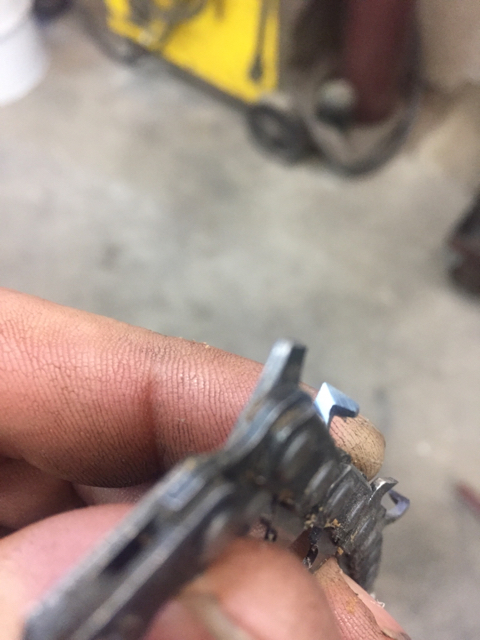

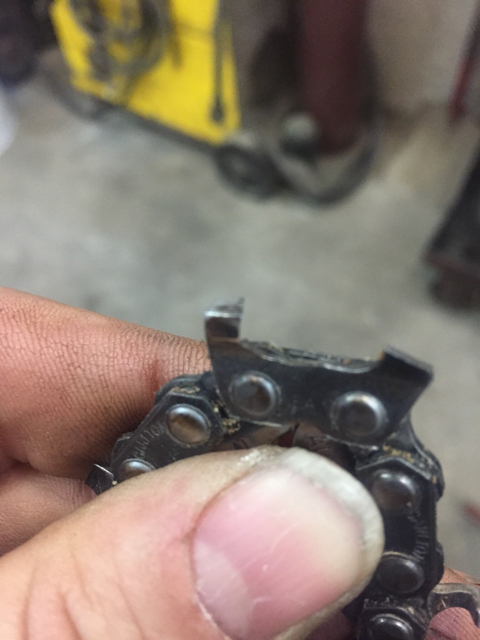

Hedgerow
7:35 AM
316
12,740
82,542
I think it's over priced for what it is but what isn't these days. I had to shim the motor to square it up but other than that I like it. It's going to take me some practice I know. I'm just trying to make a nice uniform cutting chain at the moment before I even attempt to adapting different angles and what not
Cutter looks good.
May want to move the intersecting line down just a tick to be in the lower part of the working corner.
That'll engage the wood a little better.
And like Mike said, you don't need a full side plate square to cut well, just enough to sever the thickness of a chip.
Race chain = soft wood = thicker chips = more side plate.
Work chain don't need as much.
