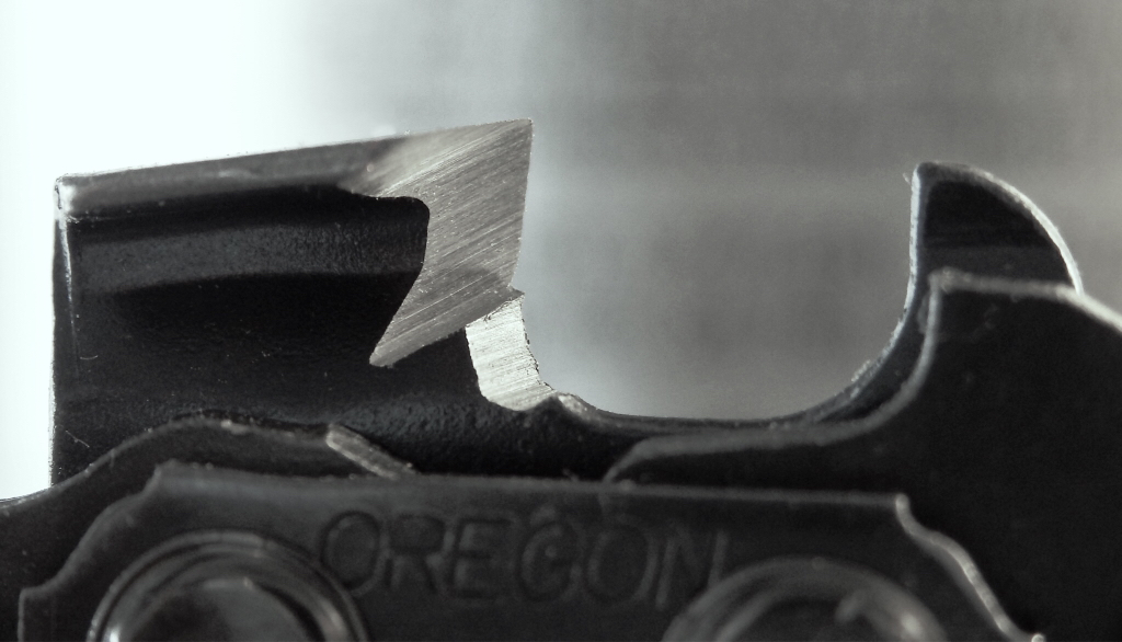

Don't overthink it Anthony. That first pic is just about as good as you're going to ever get. I like a little more forward lean for race chain than work chain. For reference this A recent pic of one of mine. Virtually identical to yours.
Remember also that the camera angles can change your perception a little bit too.
I need that tooth, that looks great

I like that junkman. I like it a lot.
What would a man have to do, to change his top angle?
On my rs2 i change it by moving the chain holder ,further out i get less angle,like 15-20 ,closer in gives more like 25-30 ,i mill with 15 square ,reg cutting 15-20, 25 is faster but dulls quicker for me.
I'll try that tomorrow. Personally, I like 22.7 degree. But others like more, some like less. Just trying to find that happy medium. Or just do them all the way I like it.
That is a good angle,only reason i go for less is durability if get a dirty spot ,it is all compromise ,22-23 is close to off the roll rslf i get ,and it hold up good.
I seem to like it. That's where it's set at now, and I don't wanna change it. But the lean is easy to change and or change back. I'll grind a few more tomorrow, with forward lean. And post it. But I can't tell a difference in the cut, from 1 degree to 5 degrees. So what does forward lean really do? And why is it important?

More will self feed faster,grab harder ,less will help a saw with less power pull a longer bar.and cut a little smoother.
What will, 8 degrees forward lean do? Where is to much then. Let's say a stihl 044. 20" bar. 3/8 x .050.

I like that better. Should feed with lower rakers.
