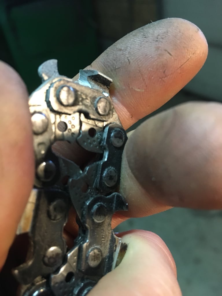

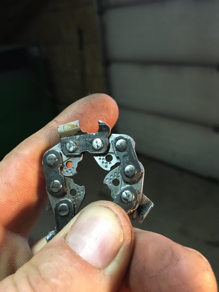

Changed the angles up a bit. This is what I've got now.
angelo c
Coal Member
3:10 AM
362
2,919
11,565
Peoples Republic of North Jersey
I would try to dress the wheel to get another couple degrees forward lean. Looks vertical or a touch backwards.

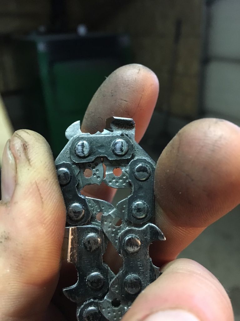

Third pic looks that way, maybe it's the angle. It sure looks like it's got at least a couple degrees of forward lean to me here.

Im guessing we should wait until you get it in the wood. (Maybe the gullets need cleaning up is about all I see.)
after all cutting is the desired result....what works best is best.

I was just using the bottom of the tie straps as a guide to guess. More lean feeds better. 0 will be a touch smoother but needs lower rakers

Those look like durable angles that will self feed,if stand up the side cutter it will cut a little smoother like Mike said
