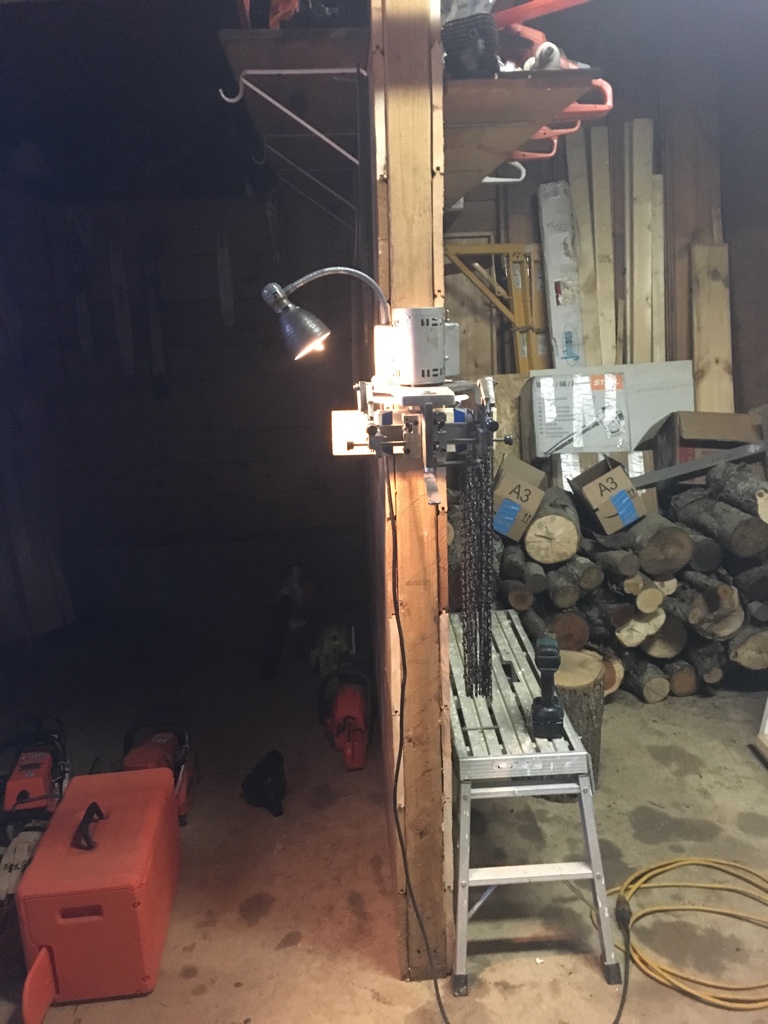

Well I think I've got the angles decent now. It seems to me that a chain that cut good round, when converted, needs a decent amount off the rakers to self feed at all. I did the 3 chains for the tests I did in the gtg thread. All three needed rakers lowered.
But they cut great. I'm going to do some now. I really need to build a stand for this. I'm constantly dropping to my knees to check the the angles.
Also it seems that keeping the corner right where it needs to be is tough. Seems to move a little as I progress through a chain.
I'm getting better with it.
I'm going to convert my 20" chains now!

That better!
no more bending over!
