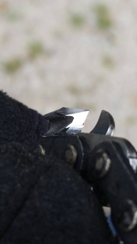

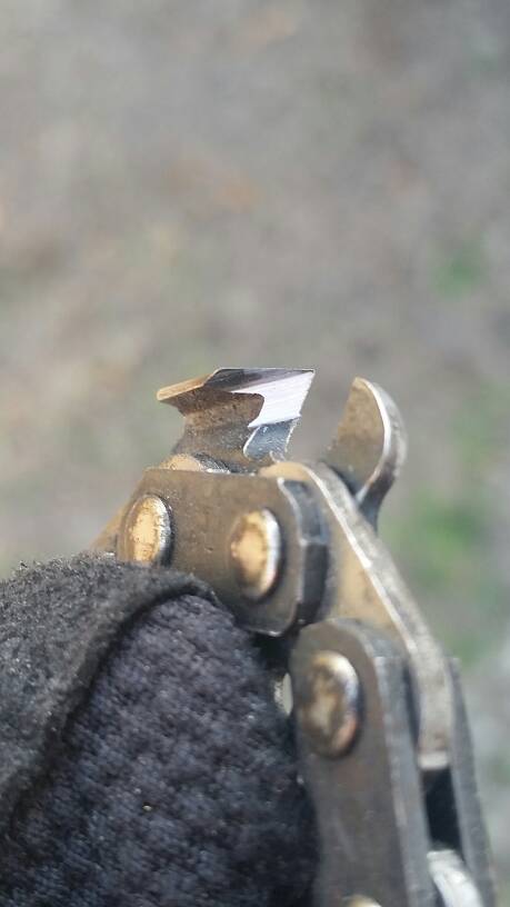

Thanks for the advice guys. Within the last couple weeks I've acquired a new 451c. Just trying to learn angles/dressing wheel shapes and it's effects.
Was playing around yesterday with some chain that needs shortened from hitting some metal.
Set it pretty aggressive...
This one the corner was slightly off, but looks nasty!
Another

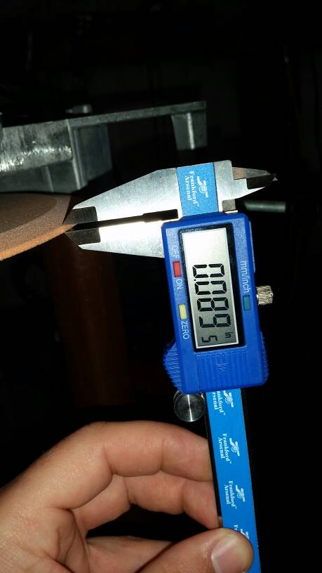

If everything is accurate this is my top dresser

Look at the cutters in the square filing thread. Page 2 there's a bunch. A really thin top plate angle like that will wear quicker than you expect, especially in hard woods like ours...
The pics here look like I described the other day on hangouts where your two chisels meet at the tip of the chain and in the corner of the side and top cutter (underneath). Leaves more "meat" on the edge. So the idea is to use a chisel instead of a razor blade/steak knife.

In normal speak, Nathan thinks your underside angle is too steep. I will actually have to agree with him here, it looks a little racy.

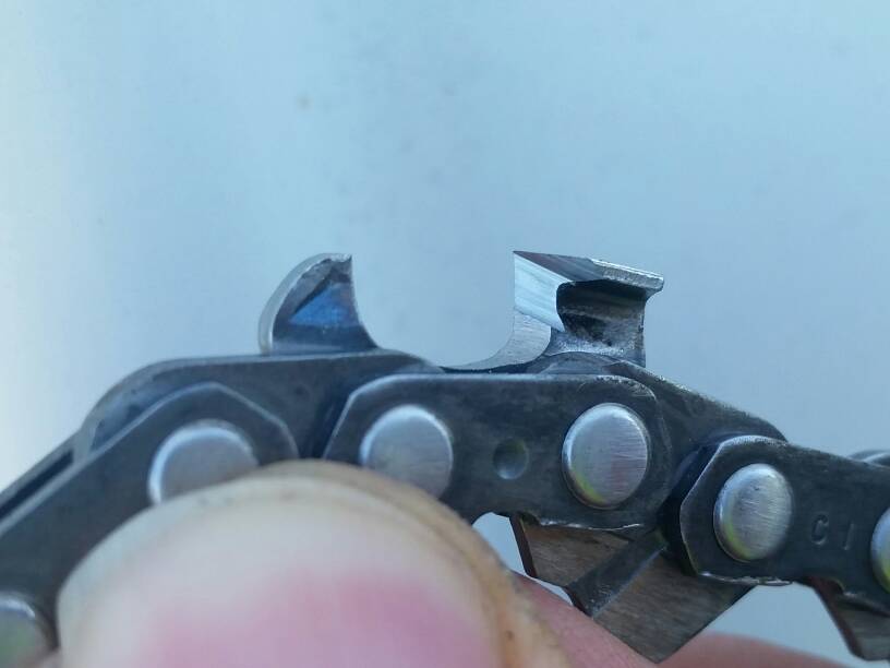

Not mine, just showing two different top angles. Gold may last longer, silver (yours) should be faster...
edit: I was dinking around on my phone, didn't realize how bad the gold tooth pic was until I got home. I think your tooth is near perfect to my eye...

I think the one guy I would like to comment on top plate angles for work chain would be Matt (hedgerow). He use square for everything and hand files most of his chains. He'd definitely know what a good work cutter would look like.
Clint, cutter looks good to me!

You can run 25-30 degree top plate for work chain. You want a steeper underneath angle if you do that. It will give you more forward lean when you do it and a stronger corner.
