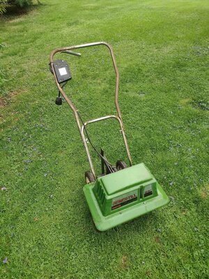

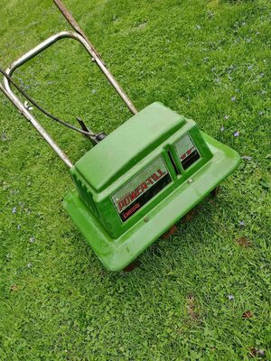

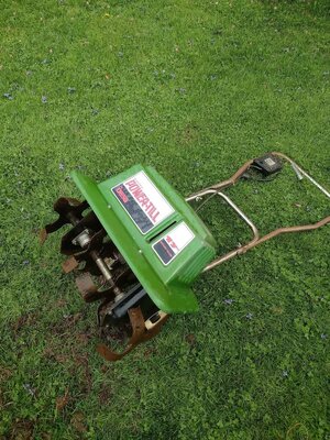

Not mine, I saw it listed on Marketplace and thought it was kinda cool. I don't recall ever seeing an earlier electric tiller like this one before.
I guess your garden better be close by....lol491741951_1205755854609529_6286860332659794563_n.jpg491763131_2497419230607476_3978166165786744849_n.jpg491744388_1807895073441662_3477926634239115290_n.jpg

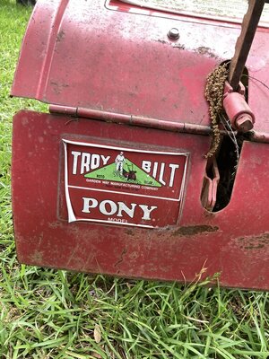

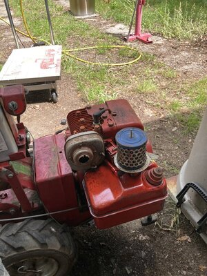

Friend gave me this one:
Needs a lot of work. Gas tank full of rust (cleaned out now - vinegar at 45% concentration), take off the head and clean the valves and intake port, rebuild the carb (rusty and gunked up bad). Had two flats (holding air for now - filled with 4 Oz of Slime each), and the list goes on and on.
Anyone know where to get new labels - these are peeling off and very brittle.

SC
Well, after all the engine work, it still doesn't run. Compression is only 45 PSI after new head gasket, cleaning valves, etc. Engine is too old and tired to work anymore. Going to re-power with a HF 6HP Predator engine. I'll save the old Briggs for another day.
