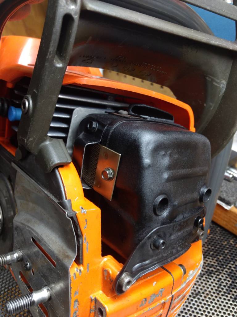

385xp.
Red97 medium deflector.
Stole a screen out of a 455 muffler for the second outlet.

That’s beautiful.
I’m gonna attempt my 1st mod on my 359/7 project.
Could you elaborate on yours?
It is exactly what I’d like to achieve.

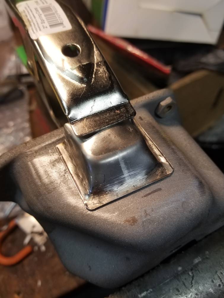

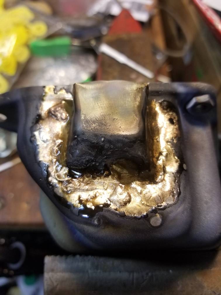

My first attempt to braze a deflector on a muffler mod. I am working on my 461 muffler but decided to try this on my 066 muffler first. I used one of @XP_Slingers deflectors. I'll be sand blasting the muffler later today.
Walkers always brazed them on. I’ve never attempted it myself
