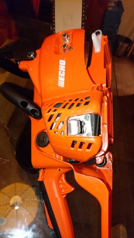

Saws shouldn't have cats. Echo CS390ESX - AKA Shindaiwa CS390SX:

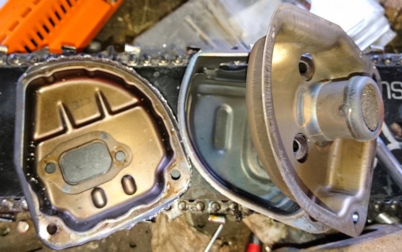

Japan has less stringent emissions laws for many small engines than the US do for two strokes. So you will find cats in some Shindo's and Echos to offset some of their KwH carbon emissions.
BTW, I used an awl much like the one pictured above to open up my 390 muffler. Mine came with my racquet stringer.
