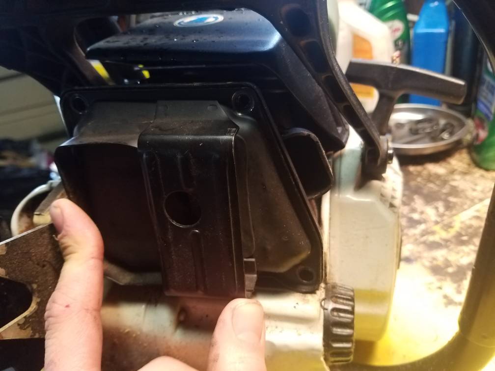

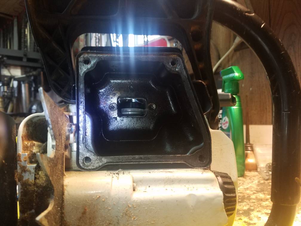

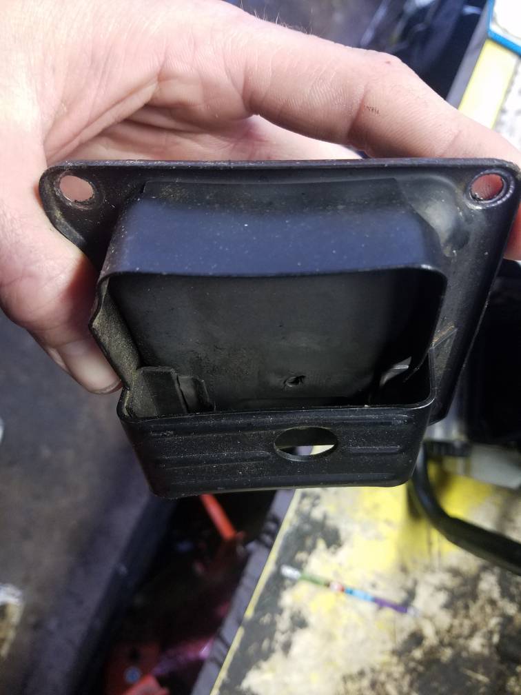

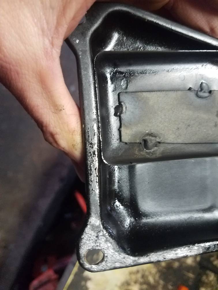

066

You still havent answered the most important question.
How do you think the exhaust travels, once it leaves the cylinder, through your muffler with its mods, and then the same question for a side discharge muffler mod ?
Dont shy away now ........... you are just about there.
Why would T4driller weld in a plate in that front cover in the post above this one ?
Think about what you did to those 261 mufflers and then think about the ones with a side or top discharge. Look at it from a hot exhaust perspective and then tell us what you believe is happening
