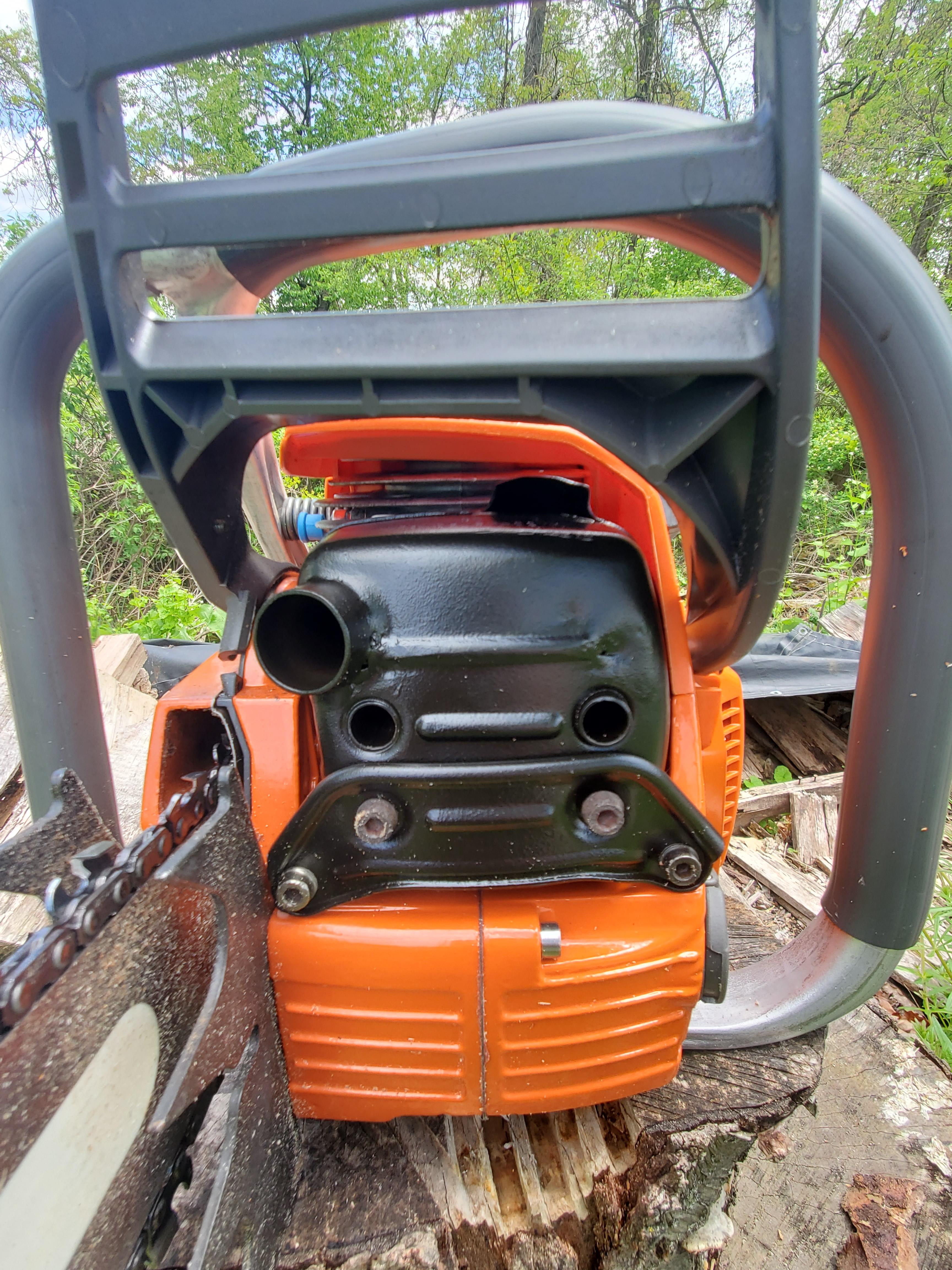

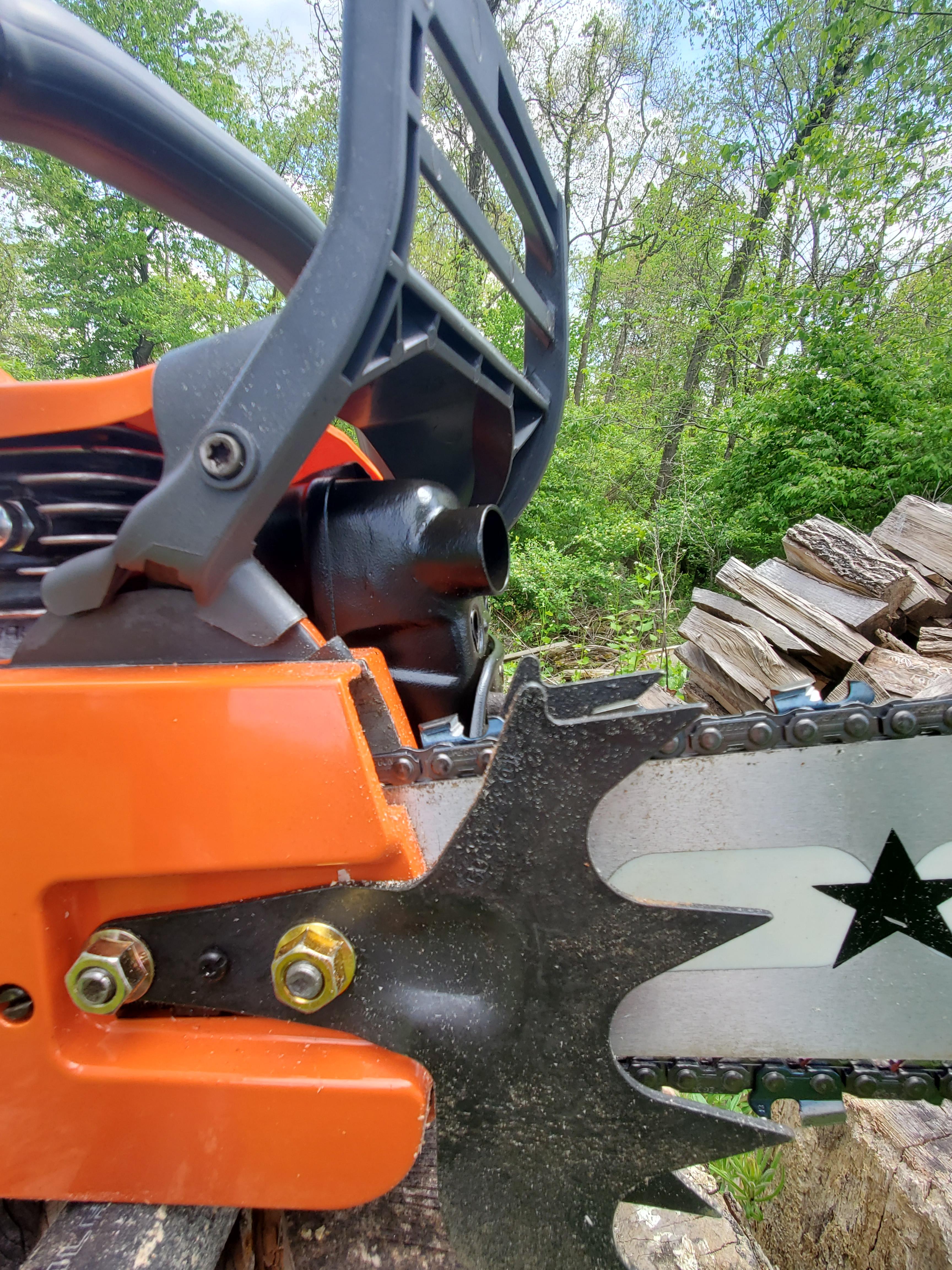

Not show-off worthy, but I gutted a green-cap Husky 235 RII muffler and opened up the outlet a little more. The far-right hole in the first pic was the only outlet hole when I started. I fixed the outlet after the last pic so it doesn't look so wonky, fyi.
