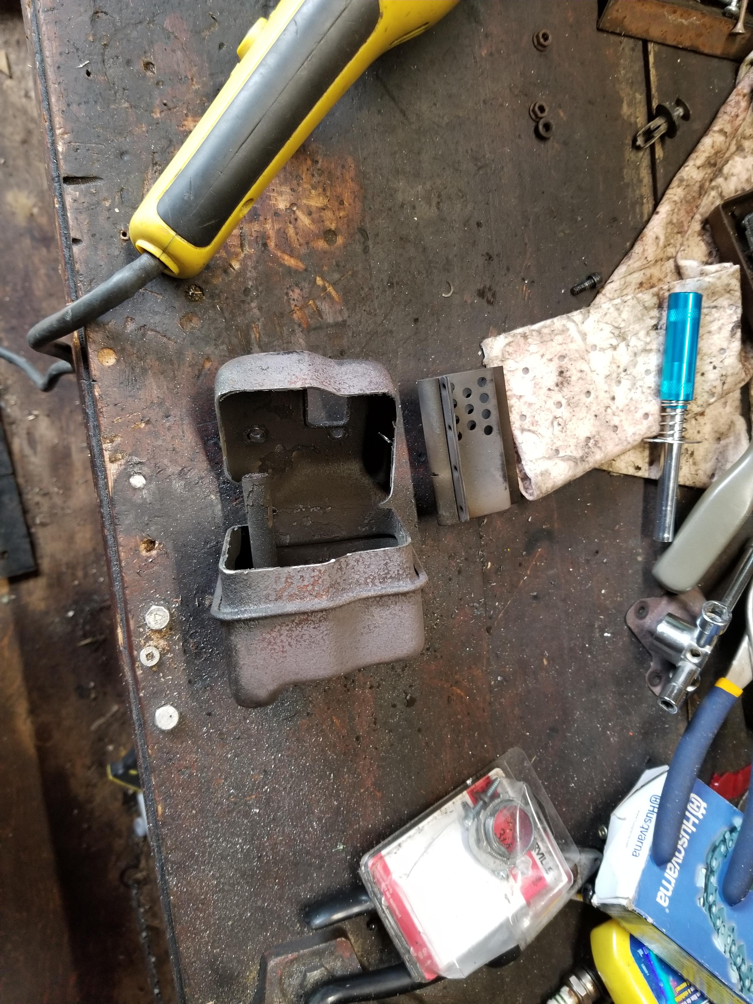

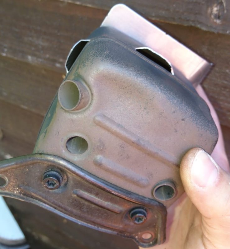

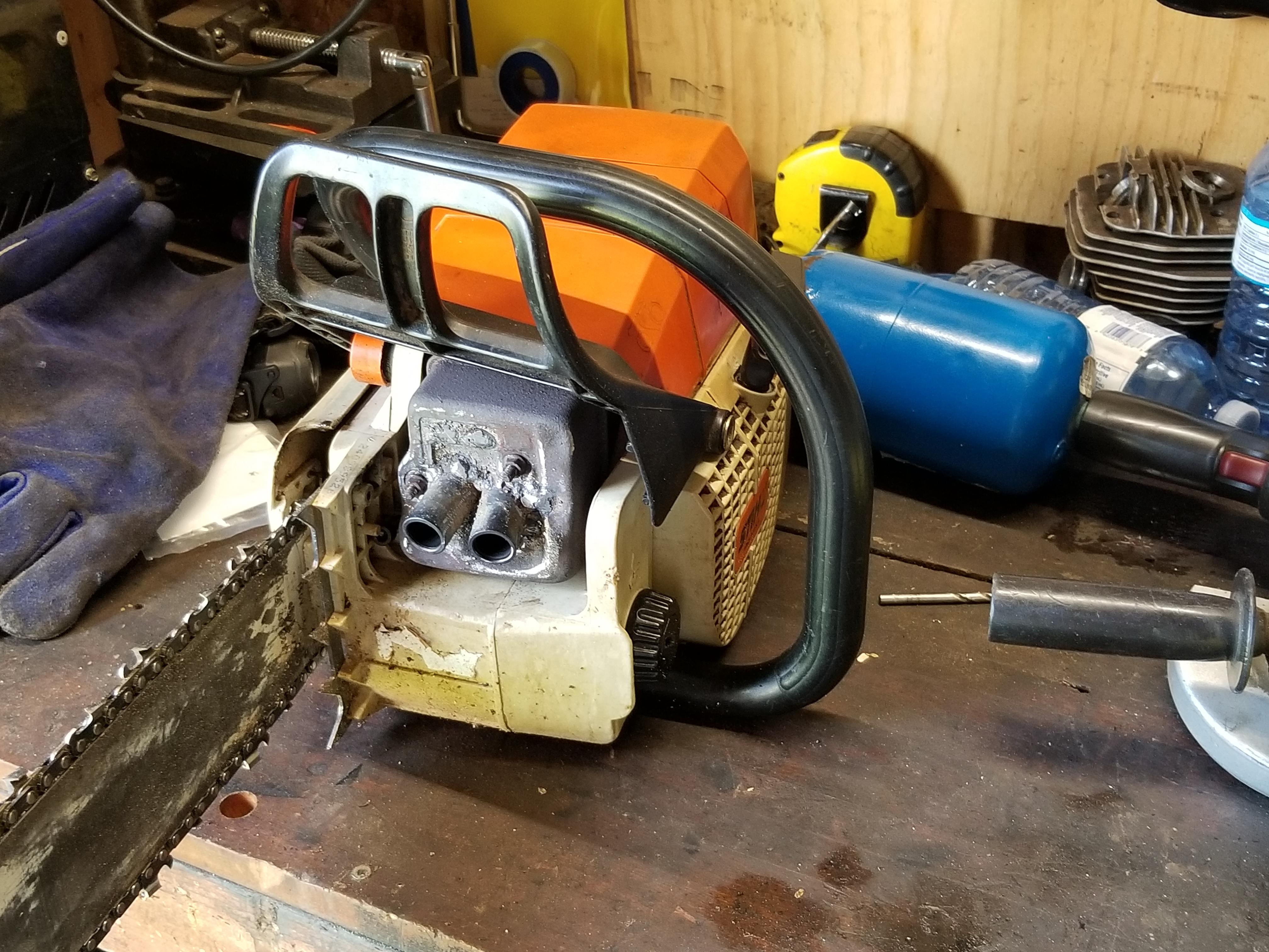

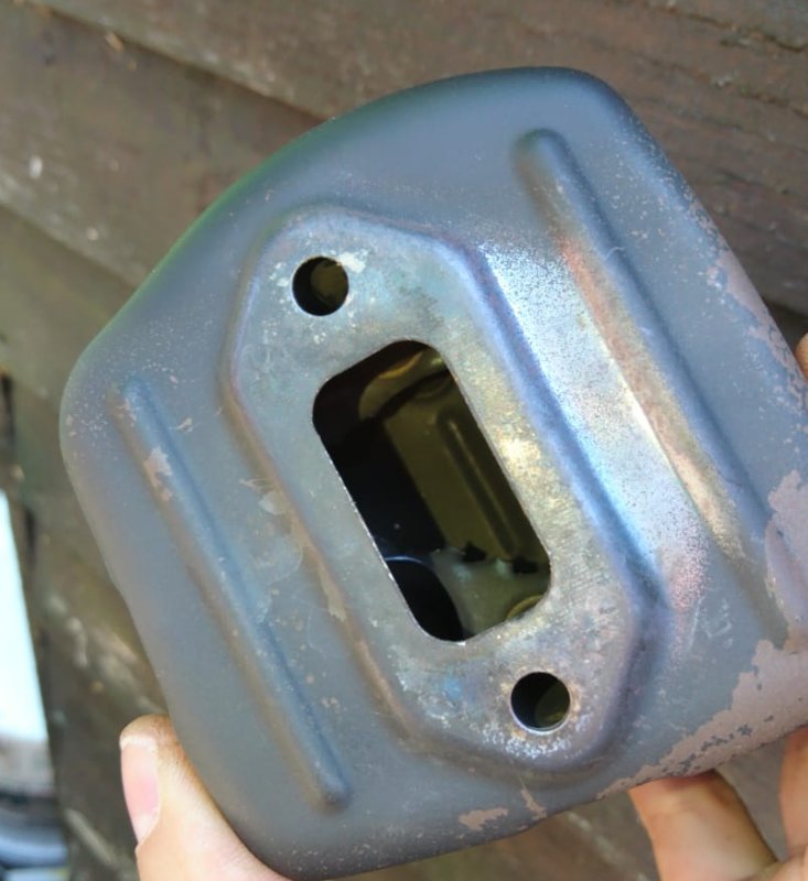

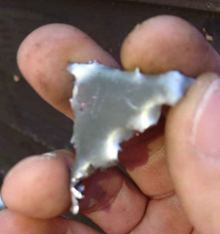

The X-Torq mufflers here have a baffle in it that's straight forwards to remove.
This is what it looks like removed before you stick the spinny thing in there and smooth it out:
There's loads of room in the chassis to clear louvres, especially under the raised hood of an XT. If I can keep it simple and not have to fabricate or braze anything, I'm all for it. This mod makes it a three port:
