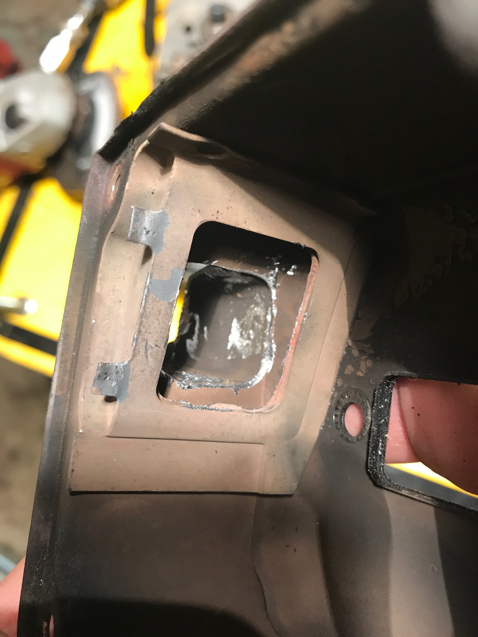

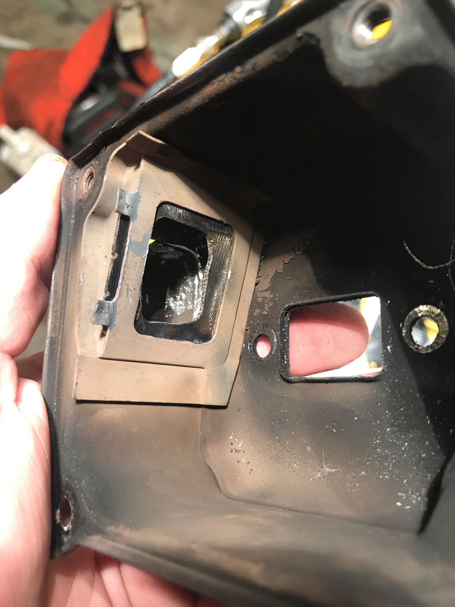

After getting a little carried away with the die grinder, I ended opening the exit up to closer to 98% of the inlet
Solve that problem by inserting the proper sized plate in the spark arrester screen slot.
I don't have a torch to braise or a tig welder to weld a proper one in but I think it'll work just fine.
