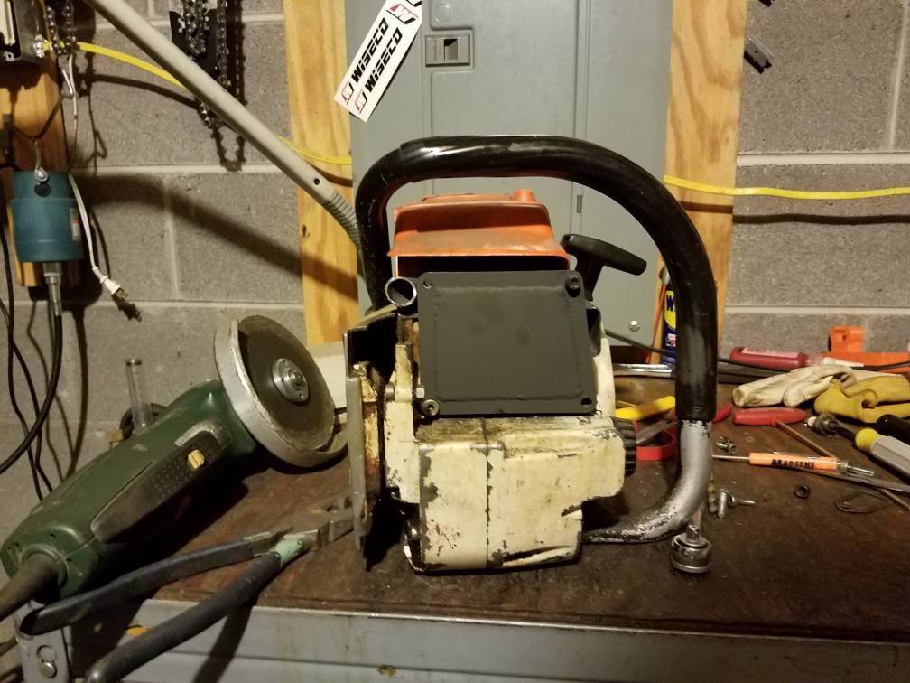

Nice! Did you gut it too? Or just smash another hole in it? :p
I don't recall any guts.
Been a while since I've owned that saw.
Ill get a pic of the mod on my 575. I cut into the side like jeremy, just a little further back. Theres a baffle and tube in mine, so i cut in right at the seam, which helps bypass the baffle. Was able to fit one of joes deflectors in there.

Guess the deflector wasnt as far back as i thought. As i said that i cut in far enough back to sort of bypass a part of the baffle. Gives it a nice pop at idle and definitely made a difference in how it runs.
