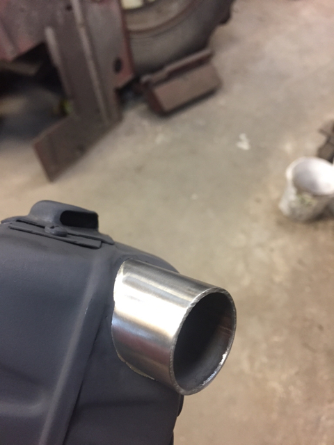

Here's a couple I did this weekend
Homemade
