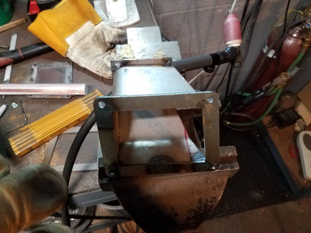

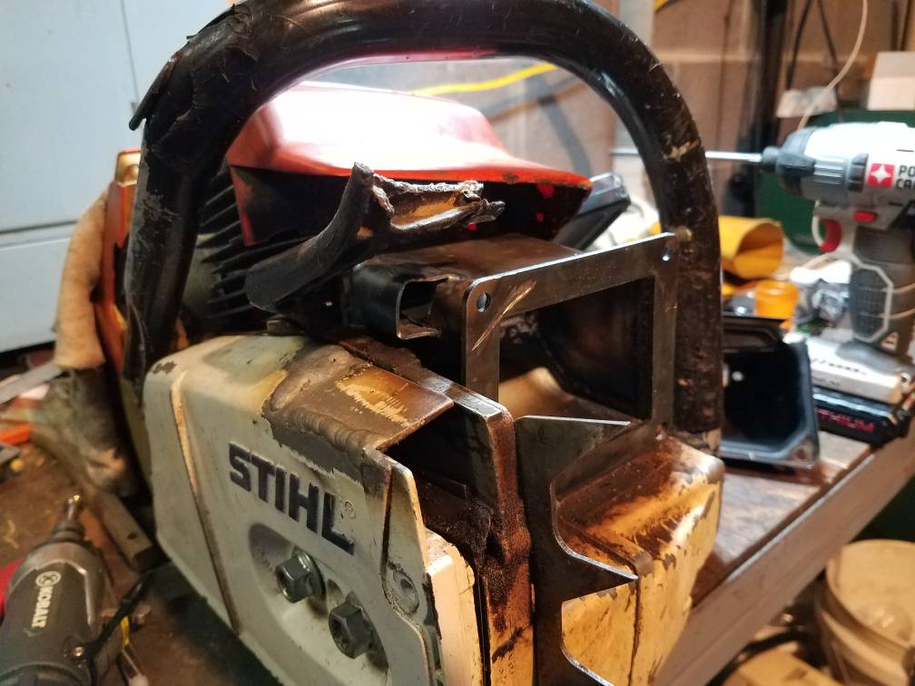

038S Muffler Mod -- Tried to think out of the box since I do not have the equipment for tig and brazing. Antique window latches - one brass one cast iron - both cleaned up and shaped with a file. Gutted the muffler and dual ported. For some reason this 038S only has a single port muffler. Left the brass shiny for fun.
Before:
After gut and cutting openings: I did go about 1/3 larger on the recoil side.
ChipsFlyin
OPE Platinum Member
8:03 AM
1244
May 5, 2016
813
5,795
Pittsburgh
Sorry post is so jumbled. Having a rough time attaching files. They will not load correctly.
Ready for install after I match the port. (got excited and had to paint) Deflectors held in place with brass screws and nuts then peened in place from the inside.
