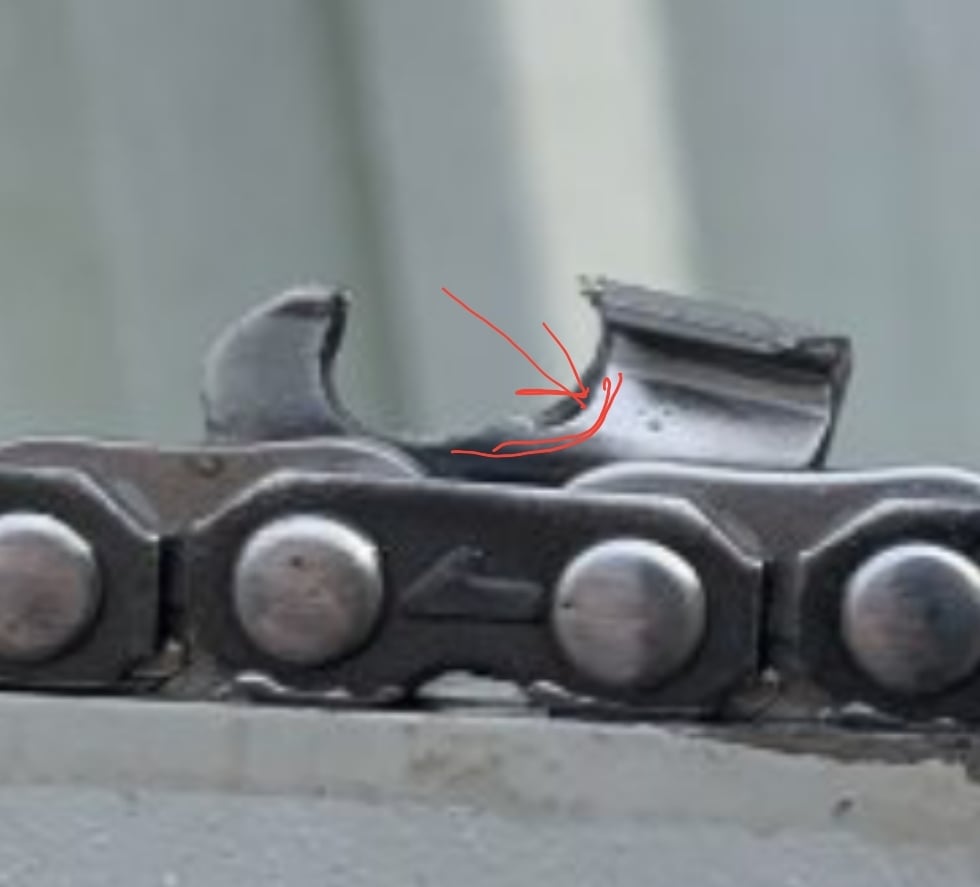

Thank you for that explanation. I appreciate it very much.Like RI Chevy said, the cutter is salvageable. .040 is way too much imo. I know of no instance where that much is appropriate; maybe a bike saw or harvester. No, it won't cut faster at .040, it will be very grabby and annoying as hell. You have a lot of hard wood in your area so .025 is where I would start, .030 at most. The depth of the raker does increase as the cutter gets smaller, but that is another discussion that makes my head hurt.
I would get the cutter right and try some test cuts before I trashed the chain.
