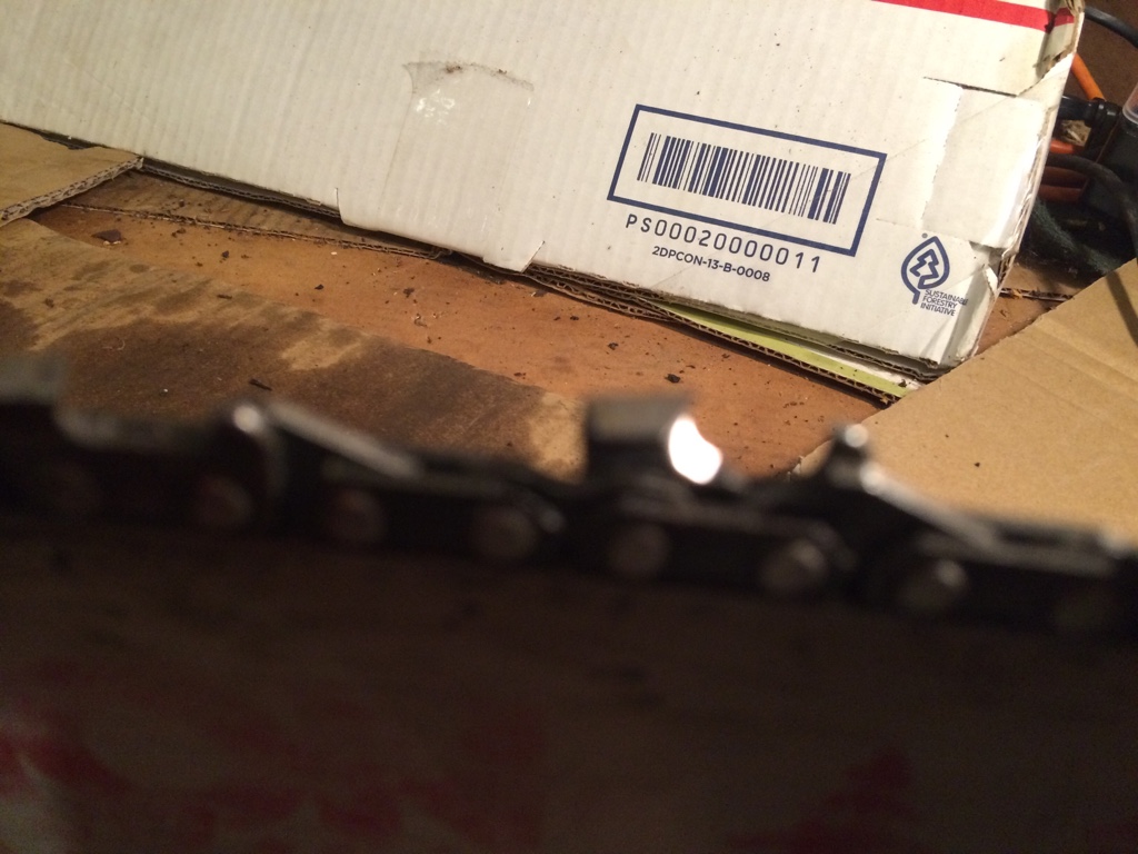

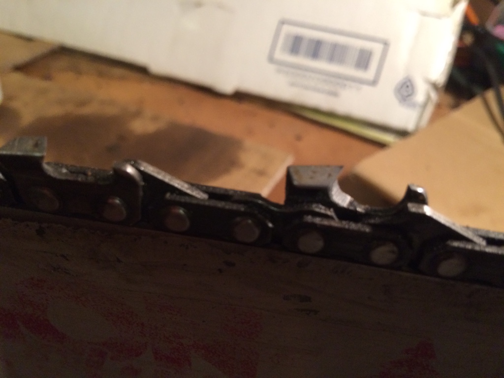

Why am i not getting enough hook? The angles are 55/25/10
Did the right hand cutters come out any better? If they look different, I suspect your chain is not centered in the chain vise.
I'm considering a 2nd grinder myself, so I can set one up for 3/8 and the other for 404. I used to do all my chains by hand + Granberg/Stihl FG2, and then I started to get into milling. It would take me a whole afternoon to sharpen three 36" chains by hand; and I'd rather be cutting.

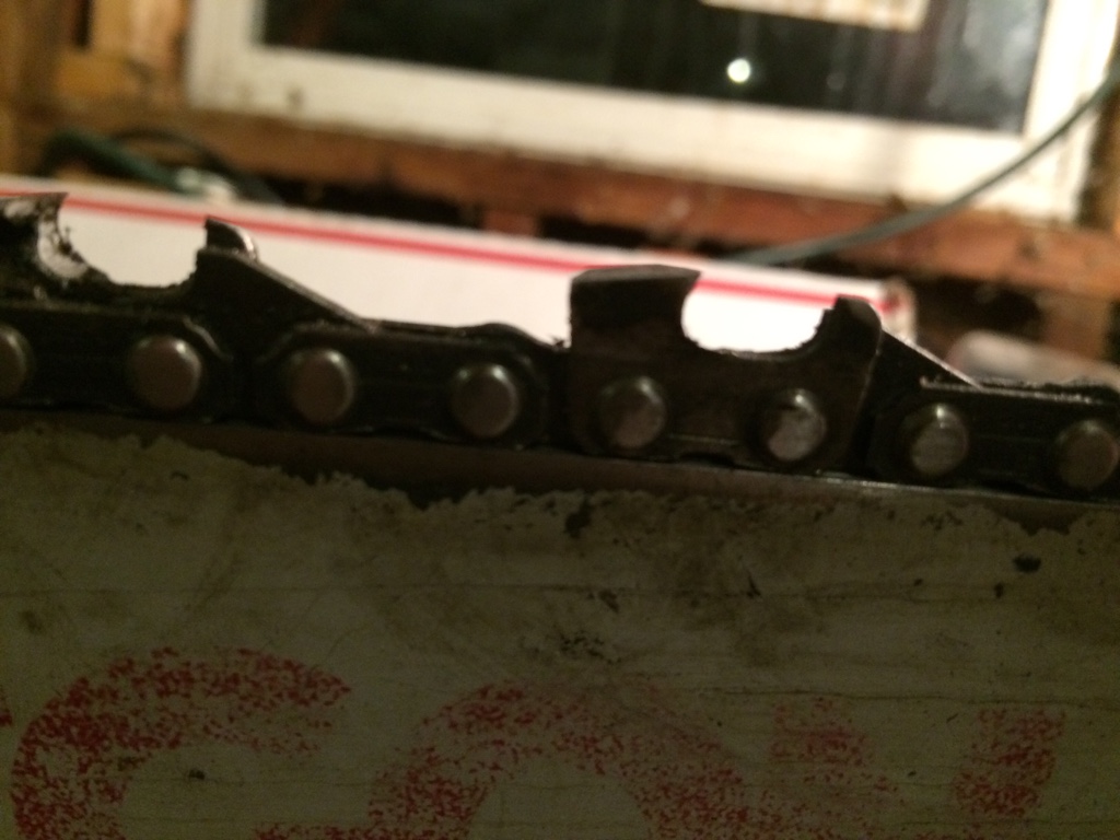

How am I doing I'm at 60 25 10 on Oregon safety chain?
