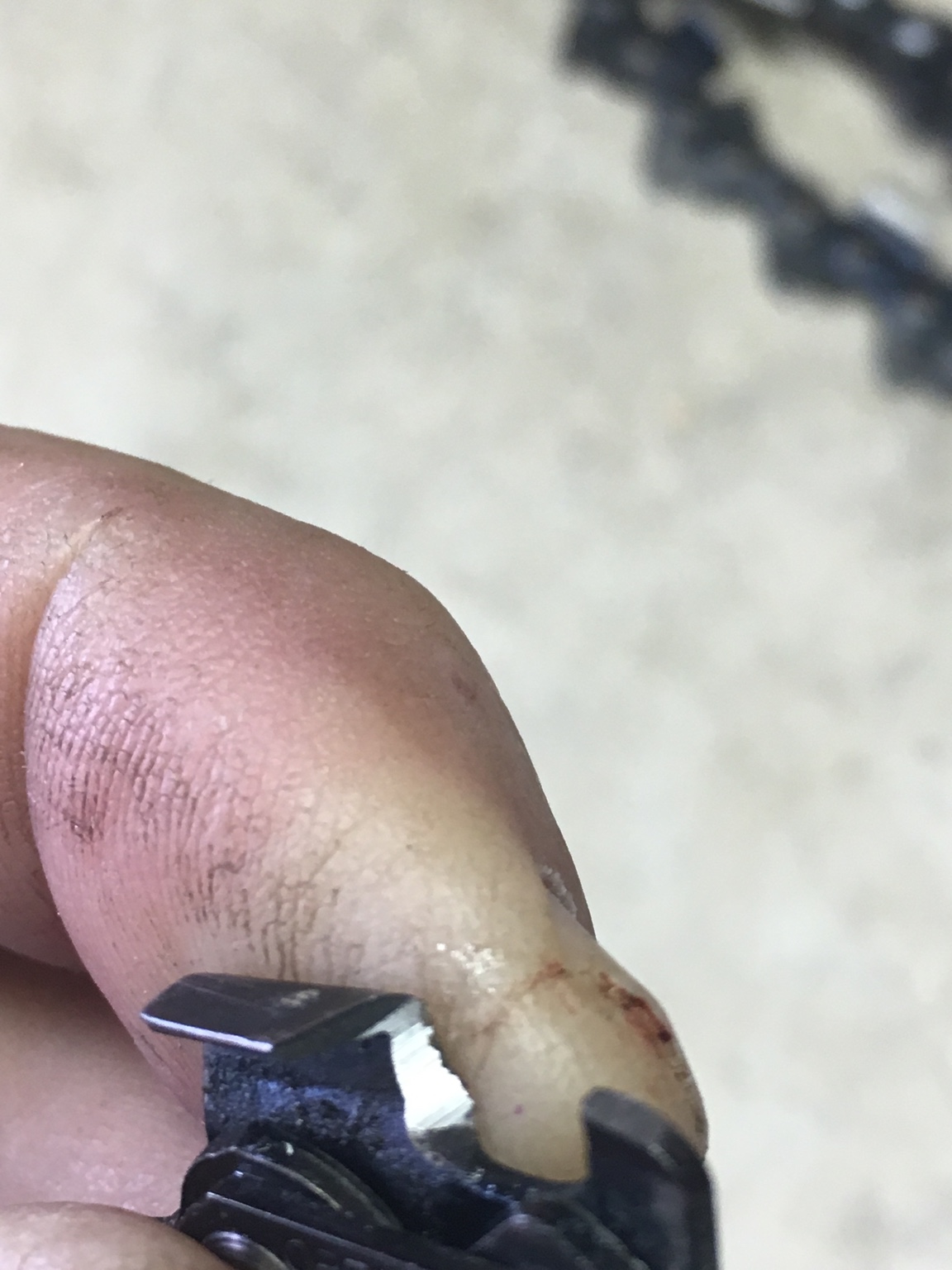

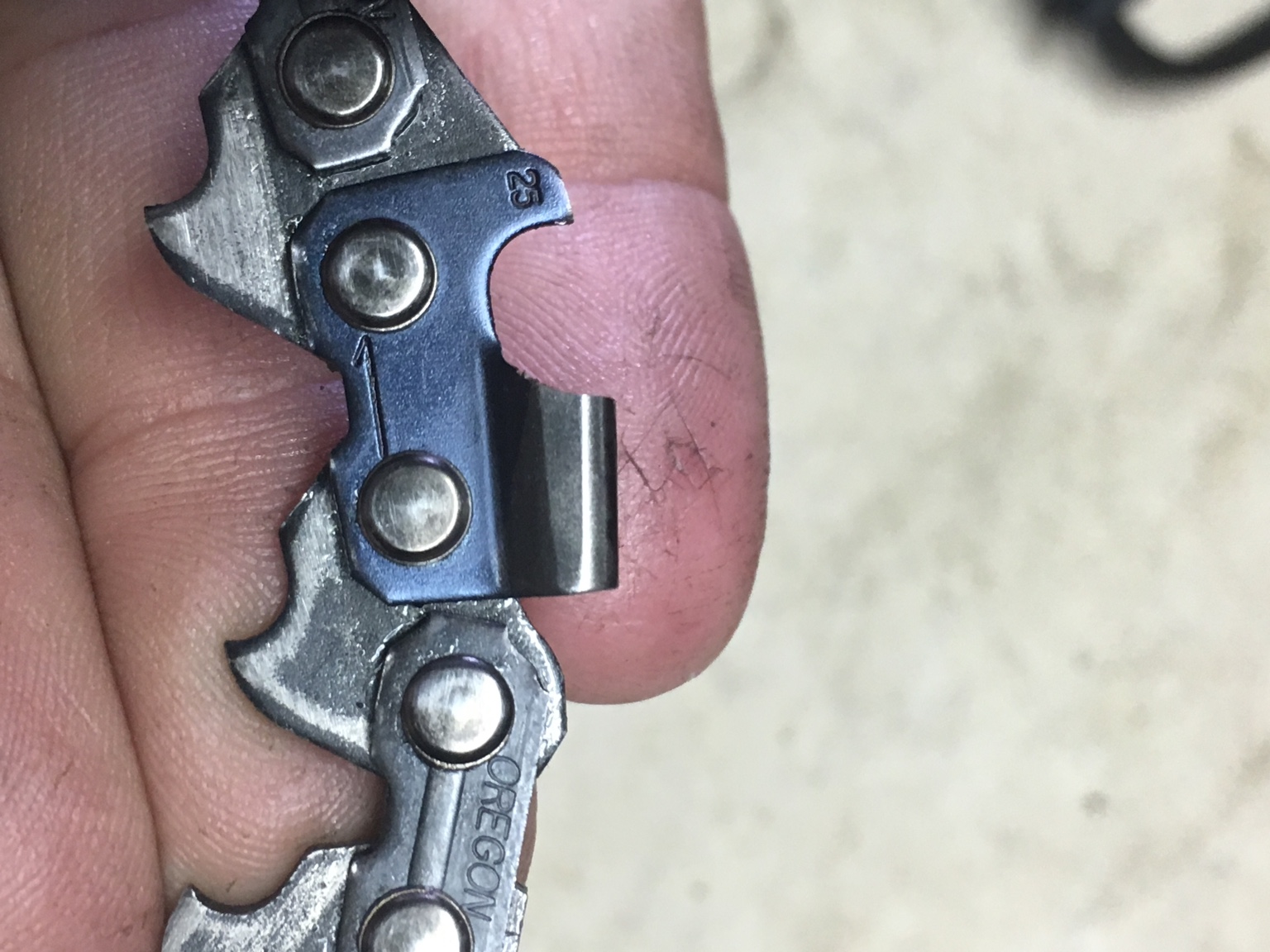

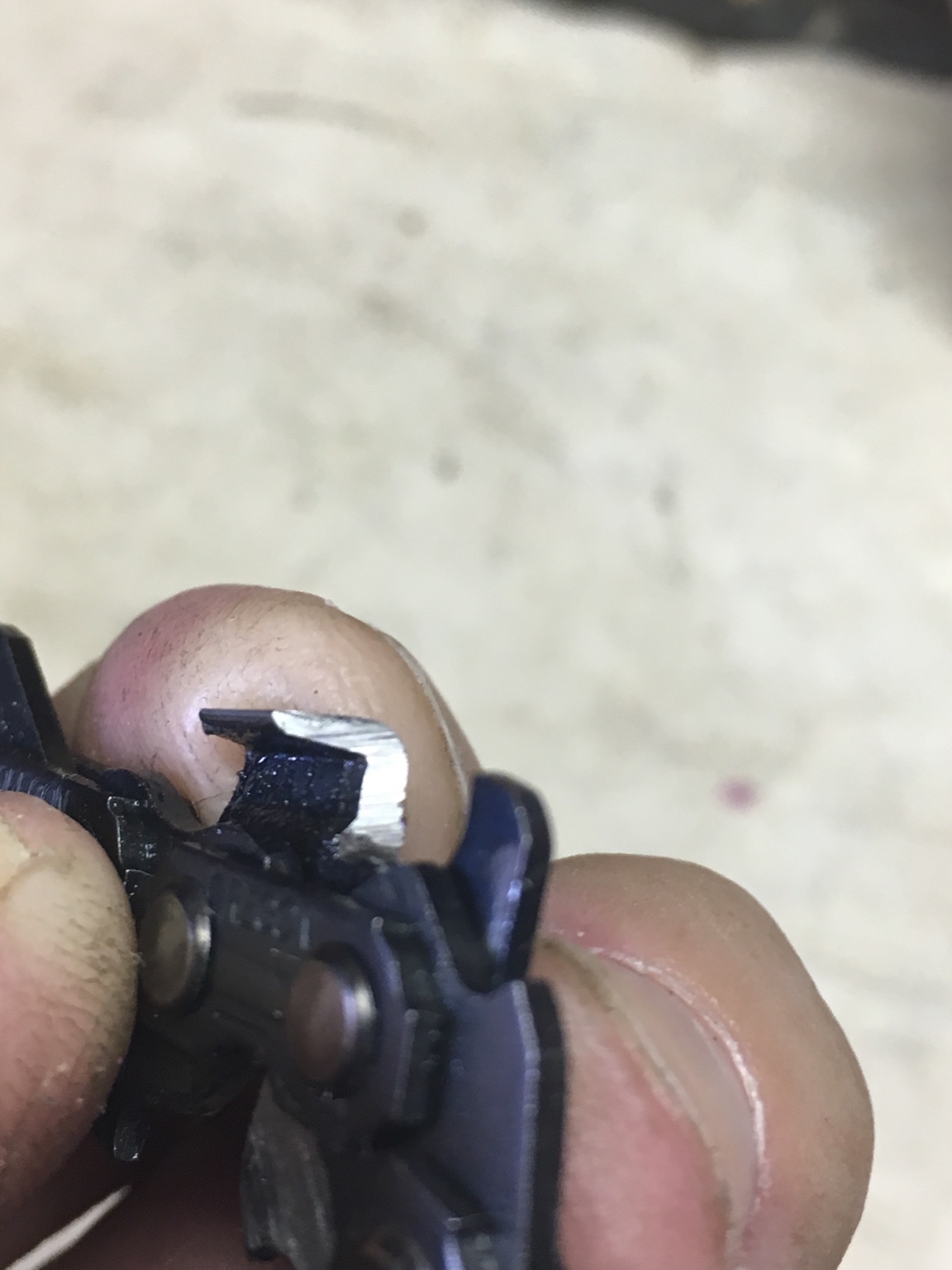

Why am i not getting enough hook? The angles are 55/25/10

Looks like semi chisel chain.
What size chain is that? .325 or 3/8?
- 1/8 wheel for picco and .325 chain.
- 3/16 wheel for 3/8 and .404 chain.
When I do semi chisel I use these angles. 55/30/0. Also looks like you need to go a bit deeper into the tooth with the wheel.

Yes semi chisel 3/8" Oregon DPX
3/16 wheel
Where the shine stops is how deep the wheel went

I always find that semi chisel never really has much hook. I believe it's because of the design of the cutter. This is a different size and brand of chain but you can see how my cutters look. This chain is due to be touched up but you can see the shape.
Sharpened at 55/30/0 with 1/8 CBN wheel.image.jpeg

Adjust on her a lol more that's not enough hook I'll agree

I went plenty deep enough so i guess 50° instead of 55°
This is the first loop i've ever had of DXP so maybe it its what it is

Kenjax tweet that grinder you know what file work should look like make that tool do what you want it to I don't think that cutter will digg in it's gonna try to skip over the wood
