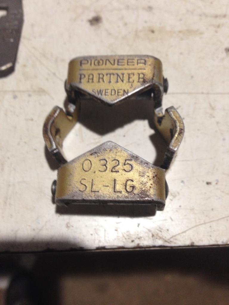

big_eddy
11:34 AM
15263
Jan 5, 2021
93
323
Quinte - Ontario
From 1989
0.325
Used almost every sharpening for 30 years, heating exclusively with wood.
Worn out many a chain and file
3/8 about 1 year old. Used maybe 10 times shows much more wear
Philbert
Chainsaw Enthusiast
10:34 AM
737
Jan 30, 2016
5,128
22,086
East Dakota
Welcome to OPEforum.
From 1989
Very cool - I did not know the history of these, or how long they have been around.
What are the rollers made from, or covered with, on the Pioneer/Partner model? Did they maybe go with a softer roller cover to extend the lives of the files?
Philbert
Partner
5:34 PM
11875
Mar 2, 2020
2,337
6,402
Poland
As the rollers wear, I use a thicker file and then the chain stays sharp longer
