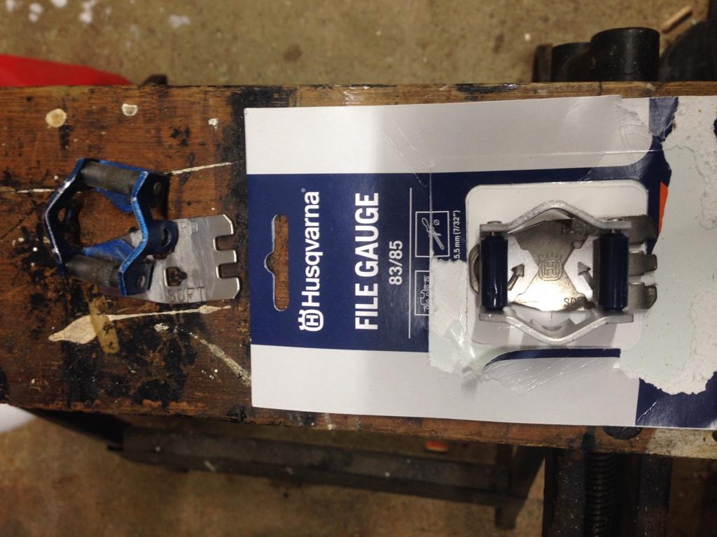

Husqvarna has released a new roller guide for their new C85 X-Cut chain.
Silver with blue rollers versus all blue
Husq part number 586938601
Recommended C85 Angles are different (30, 0, 60) versus 25, 10, 55 for H48 and Oregon LG/EXL
5:34 PM
15,011
59,916
For me the Husqvarna roller guide is miss and go.
I utilize various chain models/types and this roller riding the chains tie straps doesn't work well or at all on some chains.
The Husqvarna roller guide is a must have for semi and full skip chain though.
