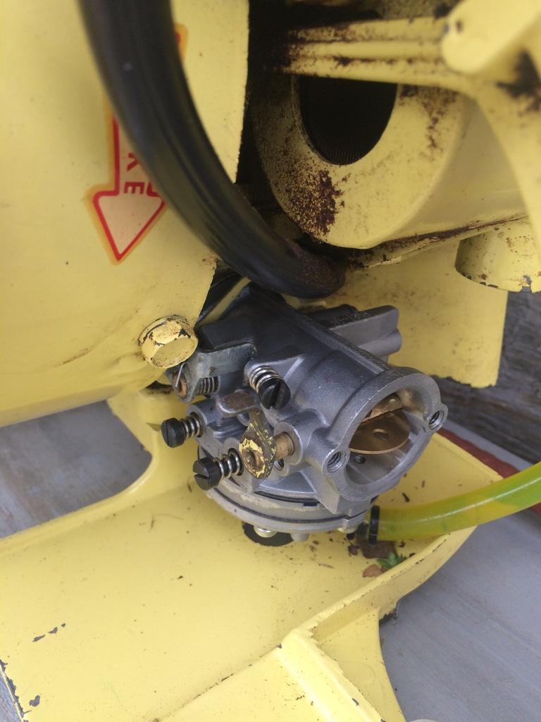

The darn carb was so varnished that everything was clogged and stuck. Soaked it in gas for a few days. It helped some but not near what was needed. I will try an AM 070/090 carb for now. If it doesn't work I will get the old carb to my friends sonic cleaner and rebuild.

I got the $13 aftermarket 070/090 to work!
Good job. [emoji108]
I liked how my Clinton turned out with the 070/090 carb I bought an extra.
It may end up on the Super 990. [emoji1696]

Little trick that I did with the choke level. 1st the level was easy free to drop close. 2nd the screws were a tad long the holds the air filter housing in place and would bottom out on the choke shaft. Used a small lock washer on the head of the screw to prevent bottoming out. Then, cut a real small piece of fuel line, 2 mm x 2 mm only one wall thickness and placed it in the thread socket up against the shaft. Now there's a soft tension when tightened down on the choke shaft so does not flip around.

I drilled the screw hole deeper for the spring & ball detent from the original carb.
