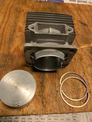

Hi everybody,I'm looking for a good parts PL5.The piston in my PL6 is scored pretty bad.I don't know about the cylinder yet as I haven't toprn it down yet.

The PL-5 & SL-11 have a really odd bore size of 1.910”/48.5 mm. That plus needing a solid skirt piston makes finding a crossover worse.
This is a top end kit from the ‘70s when the PL-5 types were relatively new.
Someone has taken a scored cylinder out to 1.937” (1 15/16”), replated it and supplied a piston w/rings.
I got the above from Chainsawlady.
It was her last one.
