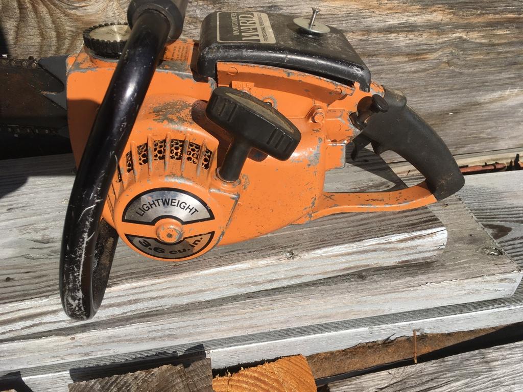

Looks like some takeoff of a Homelite XL 12 .There were a bunch of them in almost all sizes and every color of the rainbow .
67L36Driver
10:10 AM
596
9,673
41,652

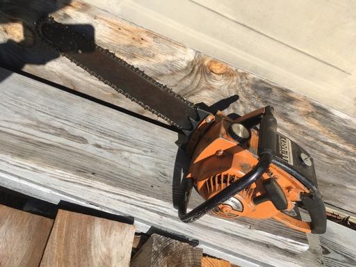

Picture of the builder’s tag please. [emoji848]
Muffler tells me it is a PL/SL-4 or a PL-5. 59 or 65 cc.
Rewind starter is if the style Remington used on Wards saws.
At any rate, a variation I’ve never seen before. [emoji3166]

It's from a for sale ad. The tags on those saws have no model numbers. Just "Chain saw" a blank model number spot, a serial number and "Made in Canada".
I have seen Tecomasters with 3.5 HP and this one at 5 HP labels on the recoil.
I was hoping it might be a 5 cube saw but looking at the oil tank, it doesn't extend to the area under the muffler.

Definitely not a PL/SL-55.
