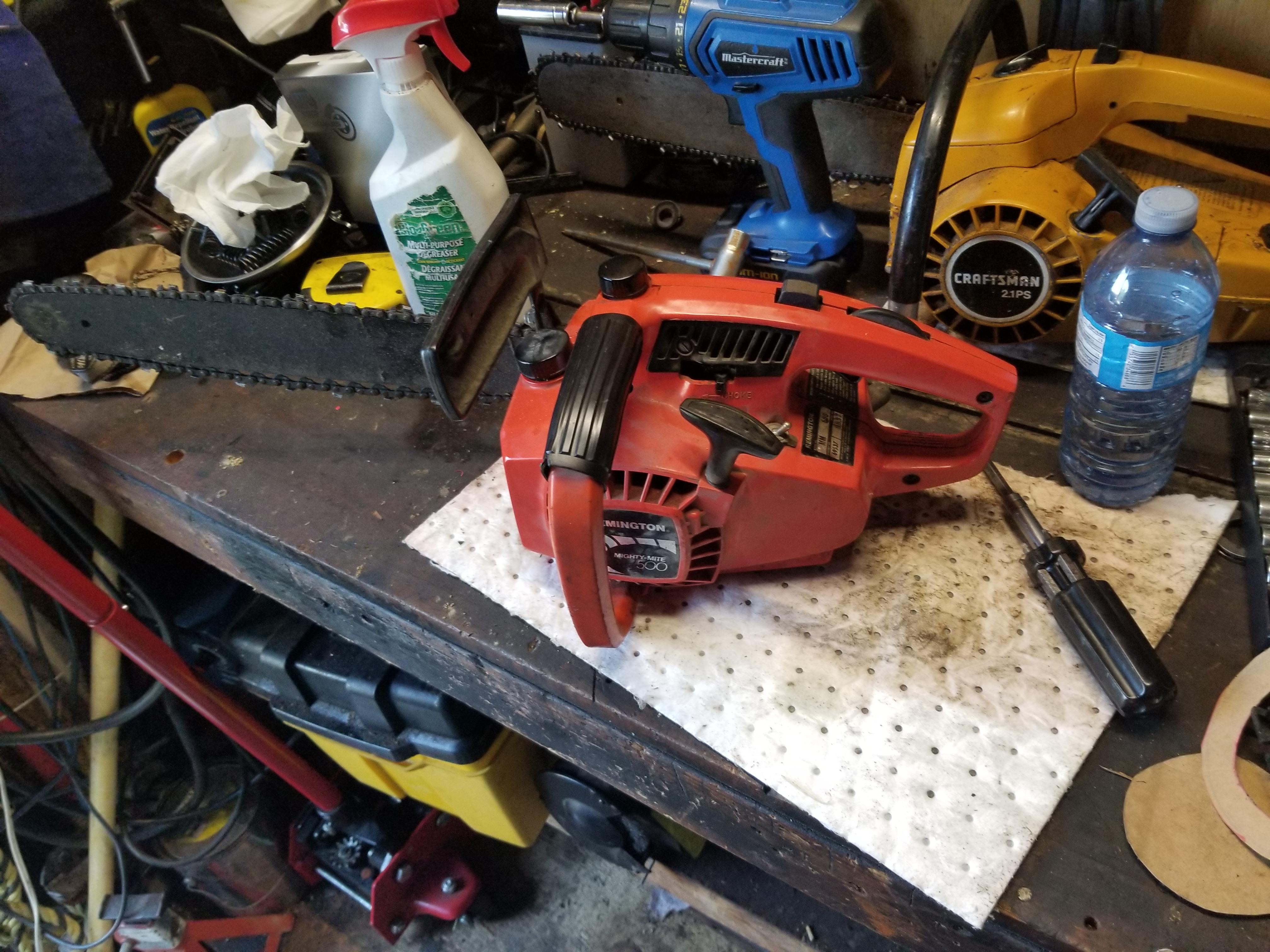

Got this little fella goin tonight. Im not sure whats worse to work on these little mighty mites or mini macs.
I had a bugger of a time getting the plastic cover off. It was full of those mud nest things. Cleaned them out and got it back togeather. Put little fuel in tank and bunch of squirts down carb to get it primed and son of a gun she runs. Pretty good acually.
Now back apart. It has a fuel leak at carb and its not oiling.
Any tips on what to look for as far as the oiling. I know someone on here is big into these little fellas but cant recall who.
merc_man
merc_man
11:36 PM
933
Feb 24, 2016
5,012
21,830
southern ontario
Or are these some sort of manual piler. I notice some funcy thing goin on whith the throttle linkage area. I was asuming these were auto oiling.

Cool little saw. I've only worked on the older Mighty Might saws and I think the Mini Mac saws are much easier to to work on overall. Only thing easier on the Remmy is carb access.
I have had 7 of the original Mighty Might saws before they changed to the numbered series like yours. All mine have linkage that actuates the oil pump via the throttle plus a thumb activated manual override. The one also had a pressurized oil tank as well as the above system. Yours looks to have a square button on top for manual oiling?
That square looking button is same plastic part as the throttle safety. Dont seem to do anything with oiling that I can see. Now i know I shouldnt.probly.vut i put a little air up the oiler hole and did get some come out. I also did notice that squeezing tje throttle repetedly made the oil move a bit where it comes out just not coming out. So how does this sytem work, do you have to keep blipping the throttle to get oil then?
Yes on the throttle on mine anyway. But there is the override if you are in a long wot cut. I've not needed it because no big cuts.
