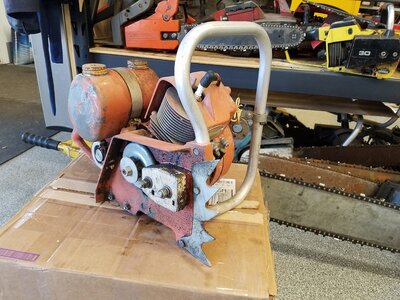

I have never messed with a Remington saw but just had a 660 land on my work bench. I've got it running but what ratio should I be running in the fuel? 32:1?

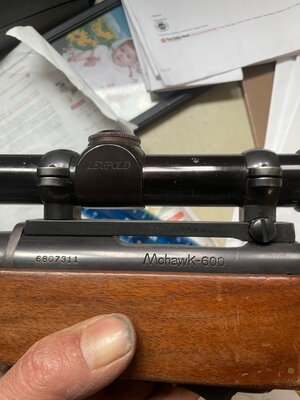

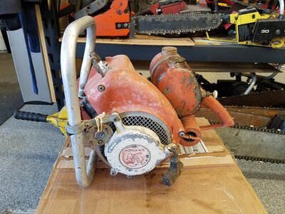

Mohawk was a sub brand 0f Remington?
I have a Mohawk bolt gun. Slightly cheaper version of a Remington 600.
As I understand, Remington first produced the 600, then the 660, then went back to the 600 and adding the Mohawk name.

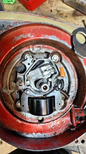

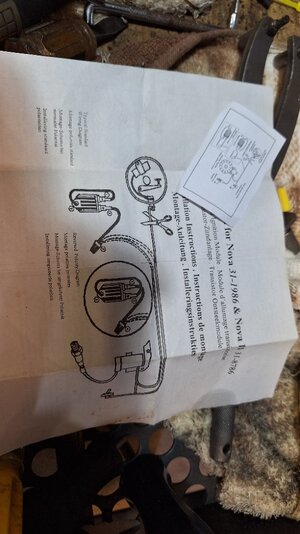

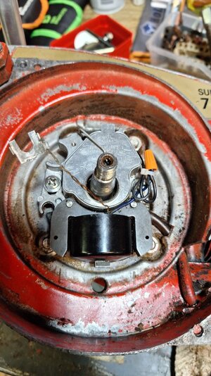

Super 754, what do you do with the bare wire coming out of the coil?

I believe that bare wire should go to ground where it is equipped with points or the chip.
Had someone contact me this week with an SP105 that had been equipped with a chip that did not perform well, I suggested he switch the leads around and voila, the saw returned to peak performance.
