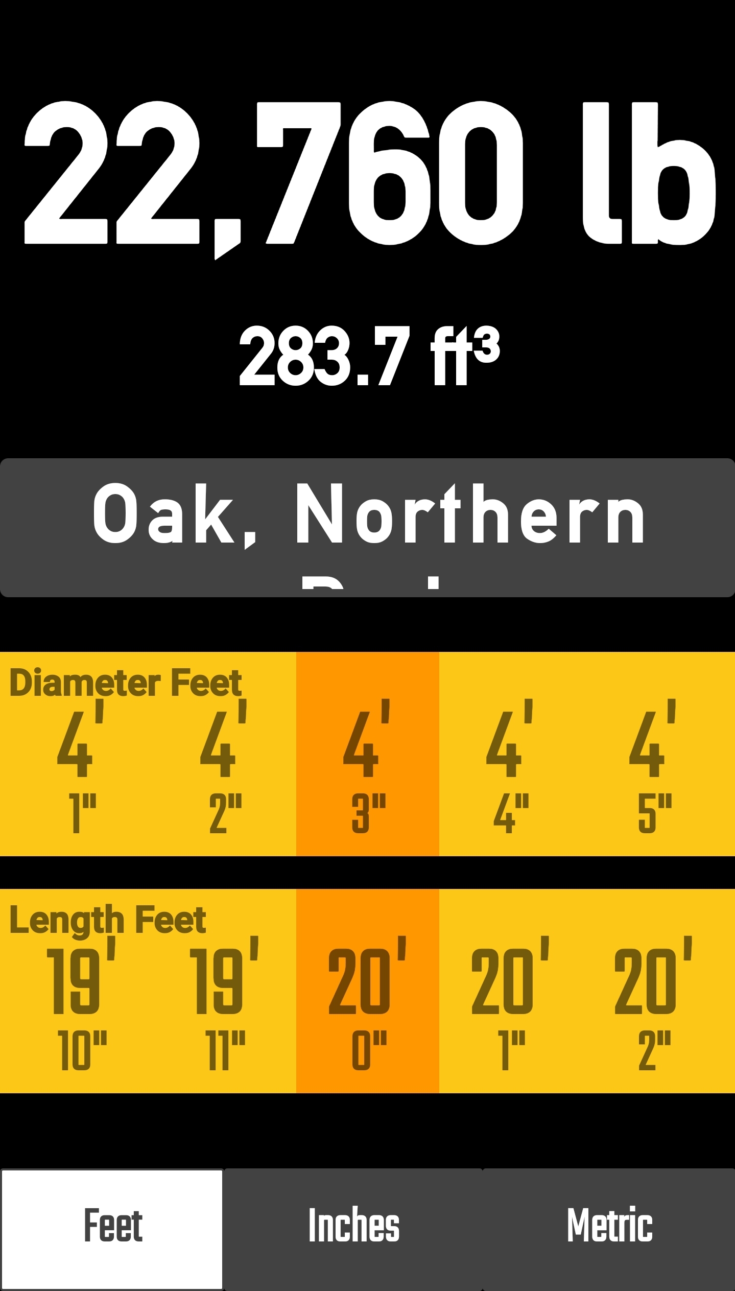

Whew!!!
APP Shows!!!
Some how I didn't see this picture, not sure how, I think it's bigger than the tree we are discussing lol.
If it weighed that much it would be closer to 4 cords than 2.2.

Your calculator must be whacked out.
That log should be near 12k-14k wet. I moved a 17ft 42" red oak log rotten outside and standing dead dry wood. Felt like 8-9k on the trailer. Heavy mfer.
Where did you find one that equaled 12-14? I used 2 they both were 20+. 52” dia 20 foot long.

I used the figures that Jason posted. 51" diameter and 20 feet long. Plugged red oak into APP.
I was saying that your picture was as big as his log, it looked huge on my computer lol.
If green red oak weighs around 5500, then that's 4 cord, not 2.2 in that log.
I like to calculate the wood I pick up by weight, on trailers I know well I can guess the weight fairly accurately.
No matter what "weigh" you "cut" it it's a lot of "chords" :band:(yes I know how to spell cords lol).

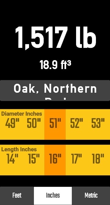

Processed another 2 rounds this evening. With just about 10lbs in the bags, if I hit a big enough whoop or bump, I’d have been on the bumpstops.
81B925FA-0F26-470F-806E-A30B4A8B3F8D.jpeg 7D4E713A-B630-4898-AD5A-7B2FFB9118F6.jpeg
This site says one 50” cookie 12 inches in length weighs over 800lbs. And I’m cutting 16” lengths.
View attachment 255142 View attachment 255143
My maff says 818 lbs at 16” long using 45lb/cu ft. This would be with very little moisture content
I actually thought red Oak was closer to 50 or 55 per cubic foot, but the first google search I looked at said 45.
9’-4” of a 50” log is a cord
A different site said green oak was 60-70 lb/cu ft. Using 65, it comes out to 1182 lb per 16” block lol
That sounds right with what I feel in my truck. I’m somewhere in between for sure. And the cordage is close to t he calculator I used. I’m guessing the whole tree is about 4 cord.
I have the little end yet too.
Different websites are all over the place when it comes to the weight of different species of wood. I am sure a lot of it depends on moisture content, which depends on time of year, location, amount of recent rain, climate, water source, etc. It's like the Rona, nobody really knows for sure.
